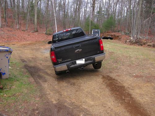

I've had the Corsa on mine for 9 years now - 9 MA winters, and it's still there! Clamp hardware is gone, but the pipes & muffler are still there. Was my first stainless system, and I'm sold. I'd have gone through 4-5 regular steel systems by now.
The other great thing about the Corsa is it's only loud when you need it to be. Cruising, there's absolutely no drone whatsoever. At idle, it's quiet, but has a subtle raspy note to it. At full throttle from 3k up is where it really barks. Sounds great. Never been so happy with anything I've bought.

Dual, but it's attached to the factory Y pipe ... so it's technically 2 into 1 into 2.

I found this one, but it's 50x louder than mine. Also have no idea whether I have the "touring" or "sport" exhaust - been 9 years - can't remember.
Probably the touring, since around here the less attention you attract from the revenue generators police, the more money you get to keep for yourself.
Mine has a similar sound, but I guess the best way to describe it would be is, if that truck in that vid were 150' away from the camera, that's about what it would sound like. It's similar, but much more muted.
