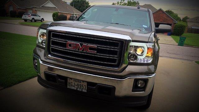

Here is a quick shot of Chewie after I finished the install, yesterday.
