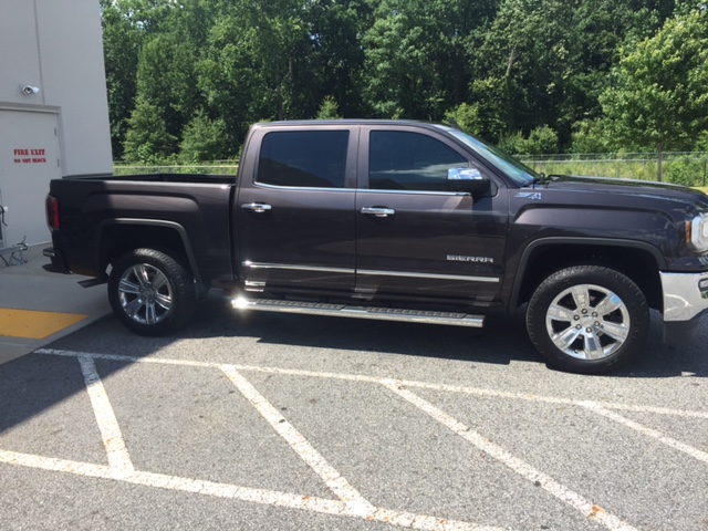

After many months of truck searching I landed on this jewel. It has way more options than I ever wanted and I love it. I'm 35 and this is the first truck I've had since high school since I've always had company cars. There was a mix up at the dealer about a bed cover so they have agreed to put a level kit on it for free. My question is they are putting a Pro Comp level kit on it and when I look the part number up it shows it being 2.25" instead of 2" which is what I wanted. Is the extra .25" gonna make the front higher than the back? Any input or pics of the same setup would be greatly appreciated.

Nice and to answer the question of weather it will be higher in the front than the back that will depend on if you have tow package or not. Bout even without it would be hardly noticeable.
Yes it has a tow package
The one with the brake controller. If yes it has the upgraded springs. This is what my old b0a751a4e154427308820b6ba7bac38f.jpg2014 looked similar load out with 2.5 level
Yes it has the brake controller. What size tire did you run?
305/60/18 had some slight rub at full lock on the a arms
