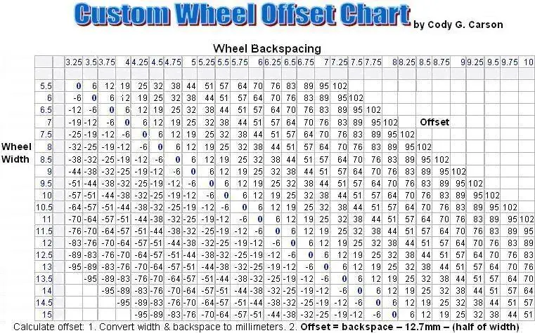

Truck looks really good, and I like the pocket style flares on a black truck with that amount of lift. Your 35x12.5 didn't clear with a 6 inch BDS?
The BDS 6inch will clear 35x12.5 on 9inch wide wheels with a 5(to maybe 4.75 inch backspaceing) however his are x10 with a -12 offset. Offset = backspacing it is just metric vs. imperial.
Handy conversion chart: http://www.stangnet.com/mustang-forums/attachments/maxwheeloffsetchartbycodygcarson-jpg.243933/
His would qualify as a custom lift/offset since the manufacturer does not guarantee that fitment.
Exactly what Alpine said above. Wheel offset did it. Might have fit if I went 9" rims.
I was hoping it would work but no dice. I could have lived with it if I had to. But I didn't have to. : )
