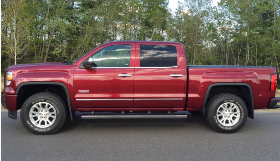

Does anyone know the offsets of this OEM 18" wheel? I have a black 18" looking for as well.
+24
How do you like the tires? White letters worth it? Looking at same setup, except with Bilstein.
I LOVE the tires. These new BFGs ride so well. They're quiet, look aggressive and handle really well off-road. The designed these really well.
I do think I personally prefer the 285/65/18 size over the 275/70. But that's just personal opinion. My cousin was talking to me about my truck and doesn't agree with me, he thinks this size is perfect.
