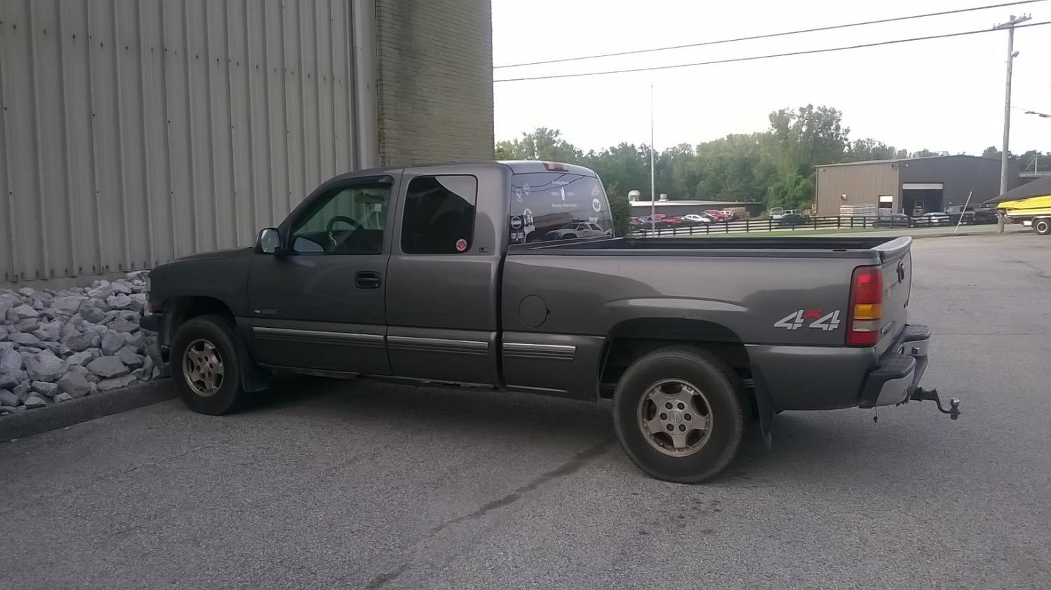

Hey,
My 1999 Chevrolet Silverado started to squeak when going over small bumps a few weeks back. I can tell it was coming from the back. I can hear it with the windows down, but not when they are up. At times it would go away, but now it's all the time. I pushed on the rear bumper this morning and I can make it squeak. Thought maybe it was the tailgate being loose and making noises but it is not. Any ideas on where to start looking and if this is something a guy who doesn't know much on how to "fix it yourself" can tackle? Really don't have the cash to take it in to get fixed and don't know if it is even something serious or just more of a nuisance. Thanks in advance.
