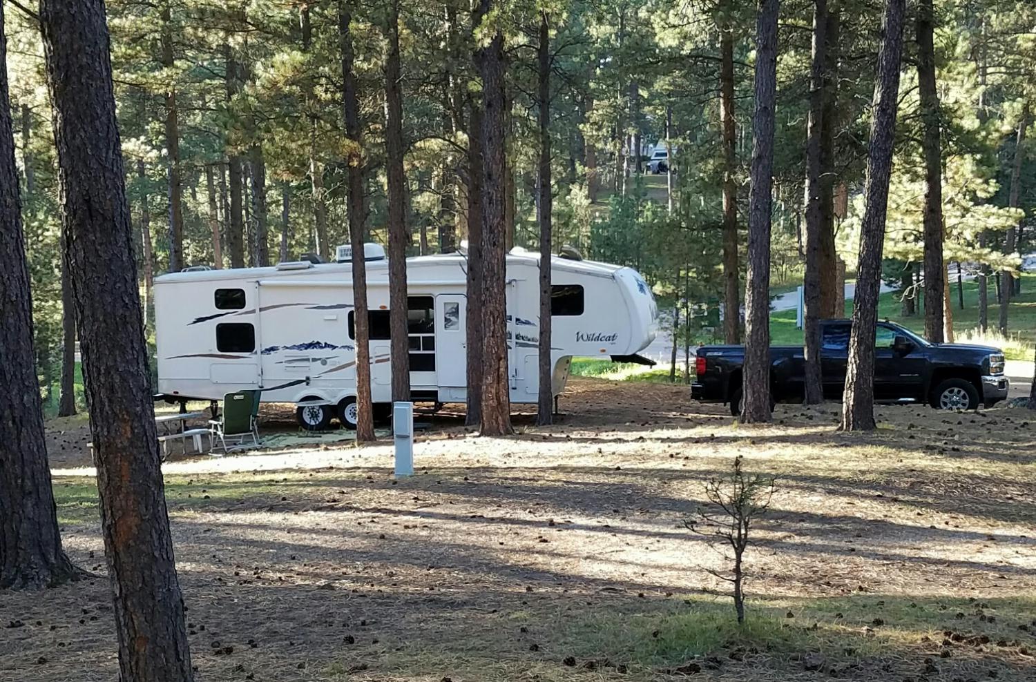

My 5th wheel is right around the same weight. Remember once you add water, gas, food and gear it will weigh more. Mine dry is 9000 lbs also but in running trim it does weigh a tad over 10,000 lbs. My 2015 with the 6.0 pulls it great on flat terrain. Toss in some altitude and the gasser does get a work out but will do whatever you ask of it without question. Pulling out to the Black hills last week I got anywhere from 5 - 10 mpg due to very strong head winds and altitude once out there. Average for the 1700 mile trip was 8.5 mpg. Around Minnesota I get 9-9.5 mpg. I keep going gas due to in frequent altitude towing and cost saving vs. diesel. If you will be towing frequently in altitude I would go diesel.
