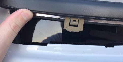

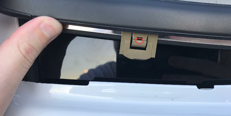

Your clip is broken. If you look at the clip in the picture, the dead center of the clip should have a smaller tab on it. I had the same trouble with mine. Luckily I had my chrome trim still and just used the clips off of it. post-54656-147801075863_thumb.png

You beat me to it. He is 100% correct about the smaller tab being broken off.

oh ok I had all the rest on so I didn't have any others to look at, it didn't look broken to me but I wasn't sure. thank you. Do you know what they should look like? I will make a trip to GMC and order some.
