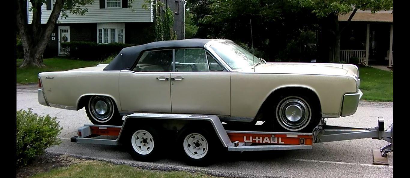

I have a 2010 Yukon Denali short wheelbase AWD. I bought it hoping it would be a tank for towing my old cars which are 60's Lincoln Continentals. I towed once with it using a Uhaul and the car weighed about 5,100 lbs. plus the trailer (guessing 2,200 lbs). The tongue weight was too much and the trailer swayed plus the 40mph winds that day. Luckily I was able to take it nearby to a friends house to store it. I have a 9 hour trip planned from Pittsburgh to Raleigh, NC.
Has anyone else towed 7-8,000 lbs with a half ton SUV on a long trip? Especially using a Uhaul car hauler (2 axle trailer not the dolly).
