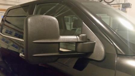

Installed the tow mirrors and harnesses today. Everything working perfectly. Didn't need any programming. The memory works and all!
Here's a pic with one tow mirror on.
Glad to hear it went well. Not a bad project to do if you have some basic tools. The 2nd side goes much faster, too! You find the tricks doing the first one.
