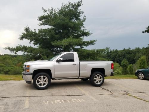

I know this is 6 months after I asked the question but I finally pulled the trigger and went with 275/60-20. It wasn't a size thing really but I chickened out on the extra weight of E load tires and bigger losses in MPG's.
Here's a pic.
