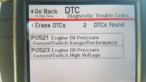

Awesome thanks for the input guys. My truck decided to voice it's opinion: post-106594-14887330817_thumb.jpg
I'm not going to hurt anything driving with this until next week am I?
I've looked around online and seen a couple conflicting posts about how to replace it, but alldatadiy says to pull the whole intake manifold off... Do I actually have to do that or is it located on the side of the engine and just hard to get to?
Sent from my SAMSUNG-SM-G930A using Tapatalk
Won't hurt anything.

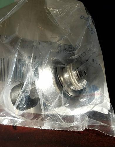

One last question... All data says to use sealant on the threads of the new sensor but it looks like there already is some white sealant on it... Is that good enough or do I need something else?
Some already come with the sealant already applied you don't usually need to apply more unless it was wiped off somehow.
Does this look like the right amount of sealant? I'd hate for this stupid thing to start leaking
