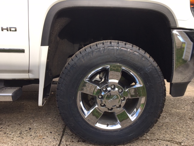

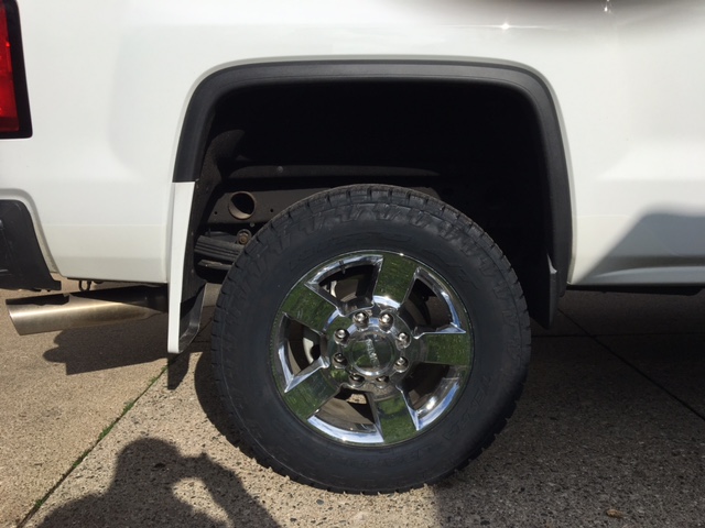

Finally ditched the stock tires. I tried to like them but now that they are gone I am much happier with the new tires. 285/65/20 Nitto Tera Grapplers on stock rims. I have a leveling kit (2") and I cut the bottom off the valance. There is a lot of room to move so nothing is close to rubbing. I had 4 different sizes that I was comparing, man the Internet is great, you can convert sizes and compare the 4 sizes I wanted, I wanted more sidewall and width, I gained 2"s in height and 1 1/2 in width, a much better sidewall too, the 295 would have worked but I like this size. I took some close pics to show the clearance Clarence? Also I am off 3mph based on GPS.

Thanks and yes, the site says 34.6-11.2-7.3 sidewall. I was looking for a lot more sidewall and this is perfect. I bet they will fit, the site tiresize.com has a great converter, then I went out and moved the tires a little bit at a time and measured. I could have gone much bigger but these look right, plus MPG is hit hard, these are off 1 MPG in the 50 miles I have on them from the DIC. I didn't need to cut the valance but it looks 1000% better, it's a free 2 inch lift visually.

Yes TG 2, I used a Rough Country leveling kit, it was new keys and shock spacers, the 295s were 295/65/20, just a bit wider than the 285s I have, your rims will work, my 285s on the Denali rim do not balloon at all and are just a bit wider than the rim. I'll have to take a pic of the valance, that was one of the best things I have done that was free, it looks so much better, I may take another inch off.

Maybe the valance but mine was cut on the bottom only, I wanted to keep the angle on the end to keep it stronger, no way you heed to trim the bumper, the 295 is so little of a difference, I can't imagine it would be more than 1/2 an inch, and from my pic you can see there is room. I have the thick mud flaps and they are never close at any turn angle and the same for the front valance. The pic I posted is only a 1.75" level, not really 2 but that
is easier to type I didn't use all the room I had, you can get 2"s but I go to Silver Lake sand dunes and with big bumps the upper arm hits a little, any more and it would hit hard. The nice part of new Keys is you can swap out the upper control arm and add the diffy spacer and get 3.5 total inches. Some say you need new shocks but some kits just use the shock extenders. Just the new UCA will get you 2.5"s without diffy spacers. I did not notice a ride change at all, the new tires did stiffen it a little but not bad.
