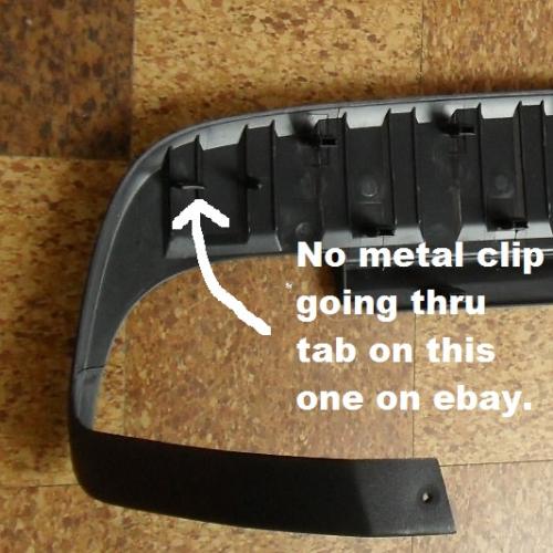

What is the little white/silver object attached to the tab extending thru the metal part of the bumper (arrow pointing to it)? I need to replace my step pad, and the ones I've seen on ebay and such only seem to have the plastic tab in this spot, but do not seem to have the whit/silver/metal retainer part. My current pad is damaged and has plastic tabs missing, and therefore I cannot see how these parts are assembled on my own vehicle. For those of you who have removed and reinstalled your plastic step pads, does this thing fit thru the plastic tab to hold it in place? Does anyone know if when I order the step pad from a gm parts website if these retainer clips for the tabs are included or are they separate parts? Any help is much appreciated!

Those definitely came off the plastic pad? Hmmm. Hopefully they are included. I am talking with a parts guy now so we will see what he says. On all the GM parts websites with the diagrams I don't see any part listed on the bumper assembly that looks like those clips, so hopefully that means they come with the pad! Thanks!
Hey just to update anyone who is interested...the clips do NOT come with the pad, they are a separate part and the number is 11562363.
