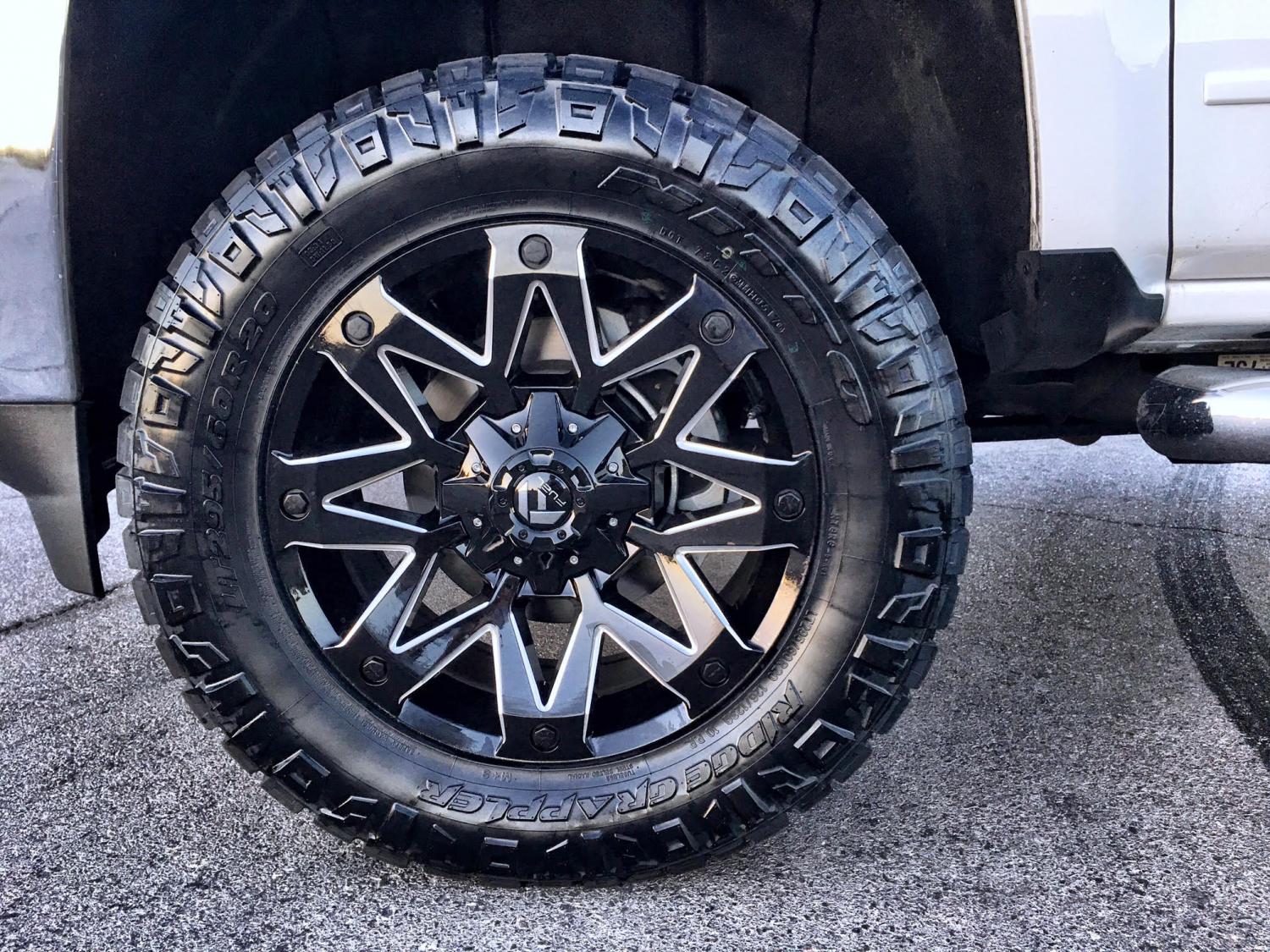

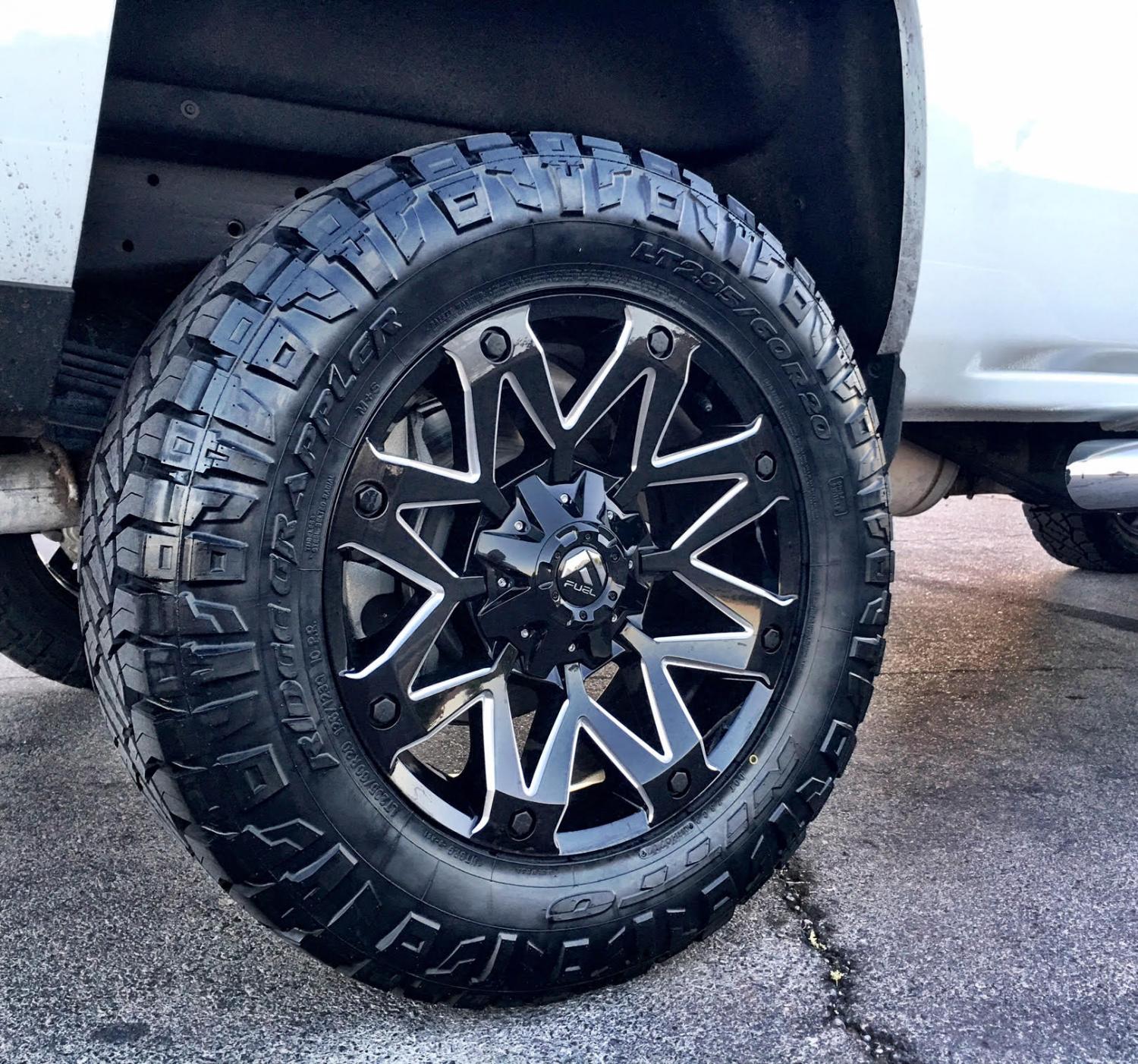

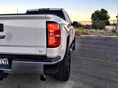

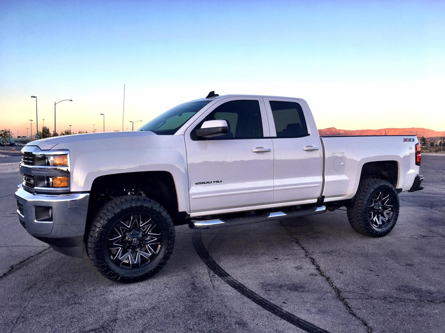

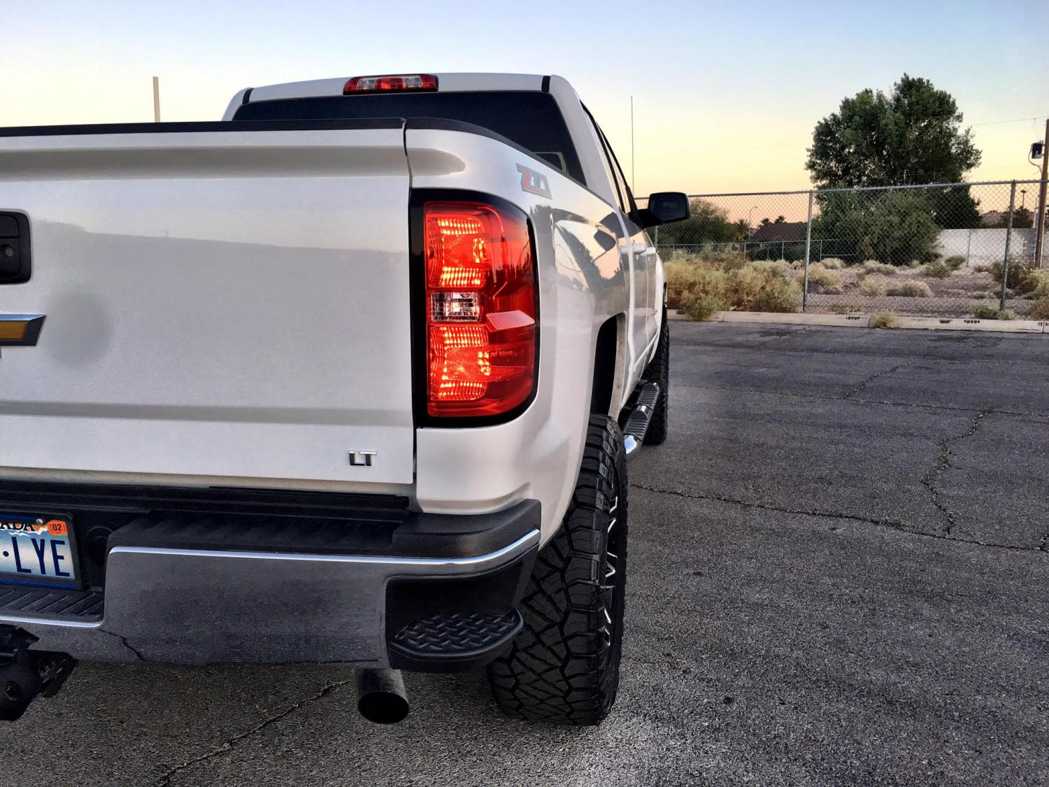

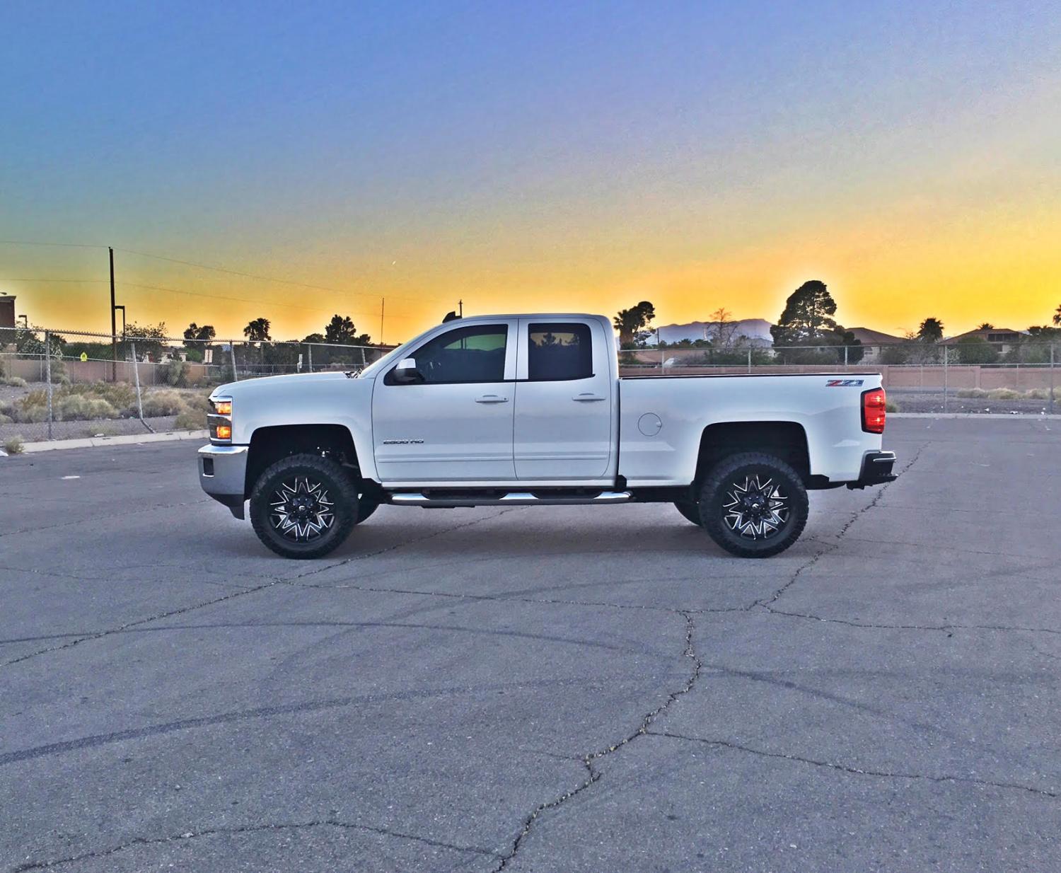

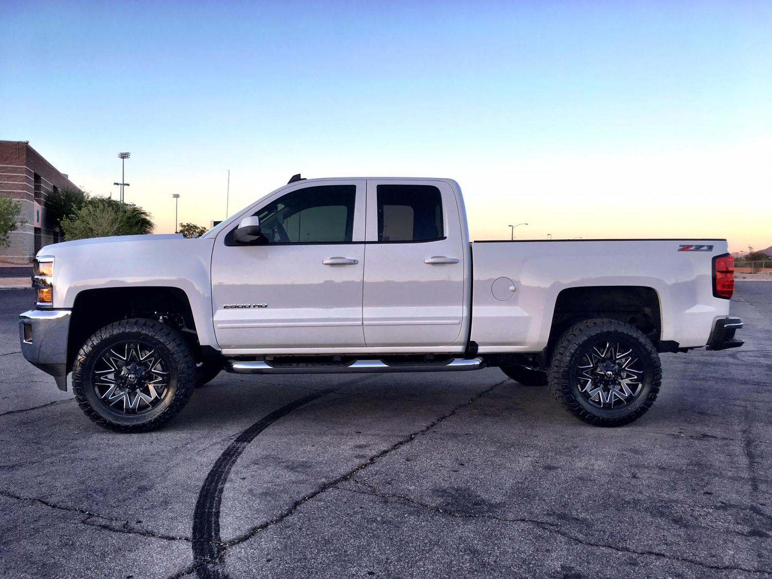

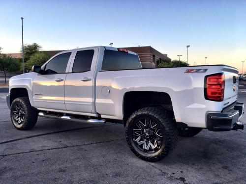

2016 Silverado 2500 - Nitto Ridge Grapplers 295/60/20
Cognito Leveling Kit (Upper Control Arms, Shock Extensions, and Keys)
Fox shocks front and back
Fuel Ambush 20x9 (Offset +20)
Nitto Ridge Grappler 295/60/20
The truck runs much better than stock! Truck is almost level. 1/2 inch of rake. Enjoy!
Do they rub any at full turn ?
With a +20 offset they should fit like a glove, no rubbing, scrubbing or mods required.
I got stock 20x9 rims on mine and was wanting to see if this same size would fit with a level kit and no rub
