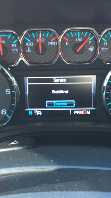

Looking for anyone who may be able to help. I have a 2014 Chevy Silverado. I keep getting "Stabilitrac- Service" warning or sometimes "Steering assist is reduced" error. Also at low speeds or at a stop the steering wheel jerks. Sometimes the truck shuts off after. This only happens every couple of weeks , but has happened MANY times.
I have had the truck to the Dealer and keep getting - "we cant duplicate the issue" They pulled many communication error codes- but said none show what they need to repair. My warranty is up in 1000 miles and I am getting extremely frustrated with this. Obviously there is a problem- but unless they can duplicate the issue .. I'm screwed. Even if they duplicate the issue on a test drive- when the truck shuts off it resets and does not show the error- and I doubt they will be any help.
Not sure if I should try another dealer and risk the same results.
