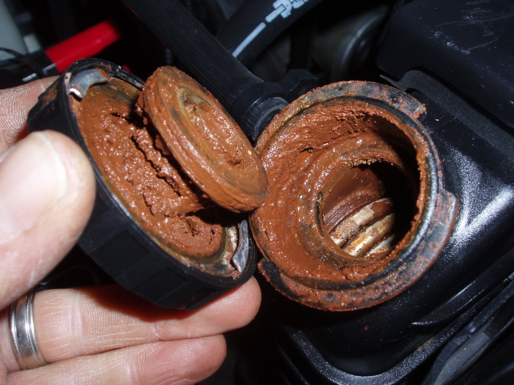

3) lastly I have no idea what coolant is in this thing, could be dex cool could be the cheap stuff..i really don't want to flush the coolant out of this thing but I also don't want to turn the dex to fudge by mixing cheap stuff or dex into cheap stuff..is their another altnerative?

Those came with Dex from the factory - I'd dump it and refill with Prestone green & distilled water.

Ended up putting sway link in it too..they were about ready to break. Went to get it aligned and was told driver side control arm won't move lol..told them I don't care if it has a slight pull, long as it doesn't chop tires...next up, trying to figure out if it has dex cool in it or not..lol joys of beaters
I'd just dump the coolant, flush with distilled, and refill with Prestone green - that's what I do with all my new used vehicles. Eliminates alot of headaches down the road.
