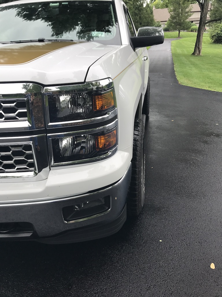

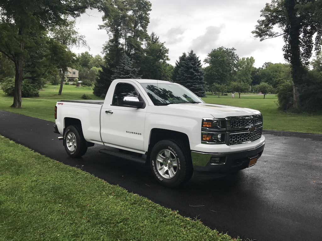

There are a lot of impressive trucks on this forum with the high lifts and bro-dozer tires, but your truck is the perfect combination of looks, functionality and practicality. I checked out your gallery...good pics; those 285s look beefy and the DC looks like it's ready to put in work, rather than carry people around! I'm getting closer and closer to my next set of tires (36K+ on my current set), and when I do, I'm going with the KO2s and 1.5 spacers. I might also go Amps to try to look a little taller.
Any issues at all with the 285s kicked out that far?
Thanks for the comments! Yes my truck gets used as a truck. Mostly pulls my bass boat to tournaments and the hunting lease. I would never do anything to it that would hamper its pulling capabilities. The 285's did not rub at all without the 1.5in spacers. I have now noticed a slight rub in reverse at full turn only. It appears to be inside driver side nearest your feet. I think if you go with a 2.5 level you could avoid that slight rub. I did not want to go 2.5 or 3.0 since it does stiffen up the front suspension. I have ran 3.0 in the past and noticed quite a bit of "hop" or bounce when going over railroad tracks or dips on the tollway. Certainly a bit scary when you have a full load of gear and a boat in tow. I added a 30in LED light bar connected to a remote switch this afternoon. It fit perfectly on the Ranch Hand Grill Guard. If you are in the market I suggest looking at Arsenal Offroad. For the price you can't beat their products.

I just finished installing my 2 inch Supreme Suspension spacers, MUCH better looking. Wheels and tires are stock 17's with OEM size tries. No rubbing and the tires and rims fit like a glove in the opening from lock to lock.
