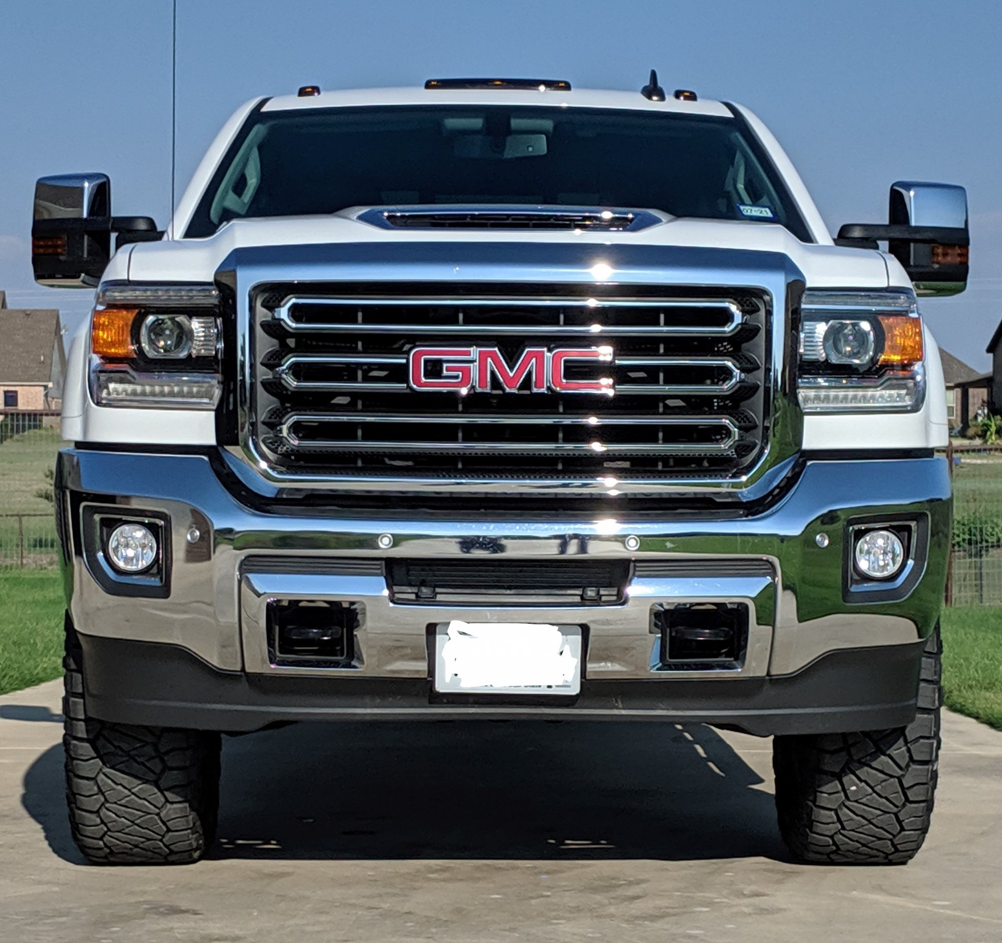

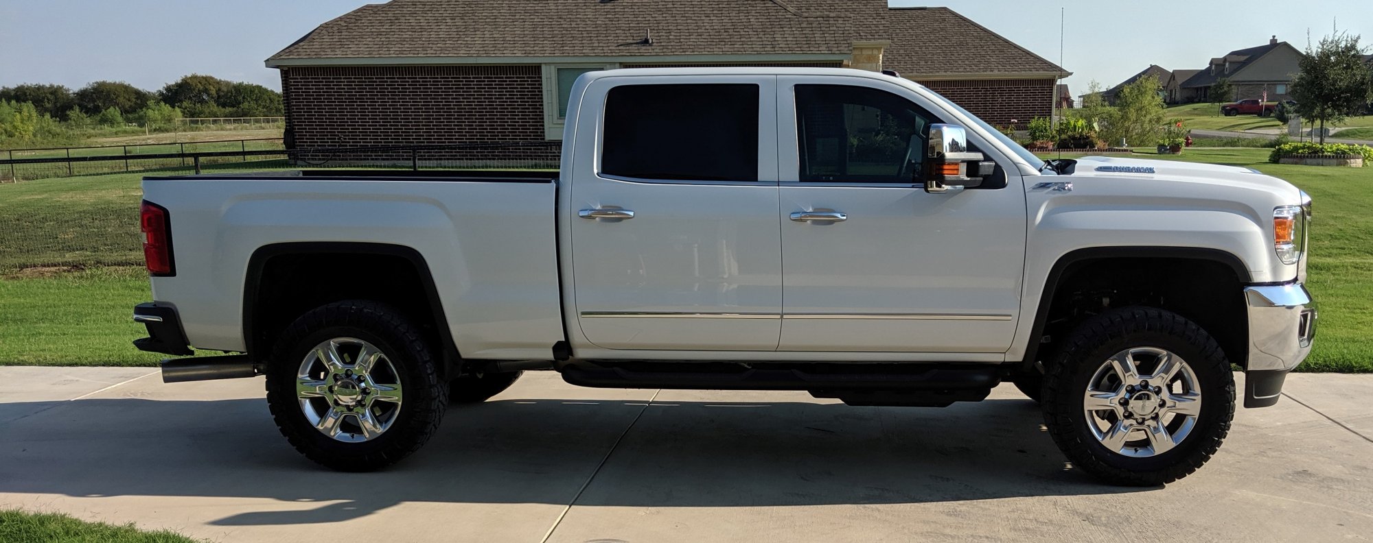

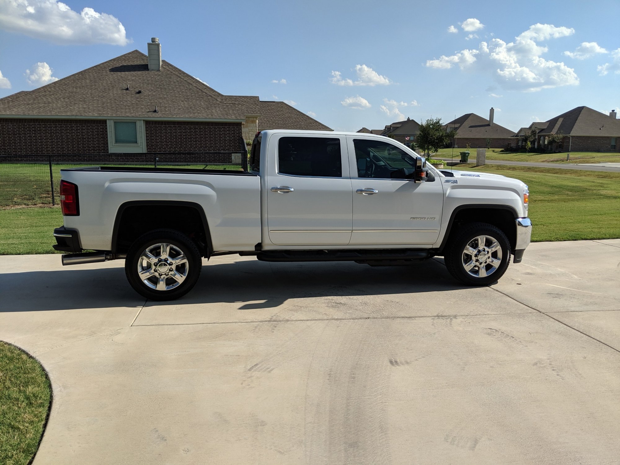

Toyo at2s 295/60 on stock rims. Cognito leveling kit with uca's and Bilstein 5100s all around. Tires went on before leveling kit with no rub whatsoever on factory ride height. About 1/2 inch clearance at full turn4d9f380e18ab3f68f1617fbc94ad96b4.jpga9322e6e037a0d7b640024fcc4e216c0.jpg
