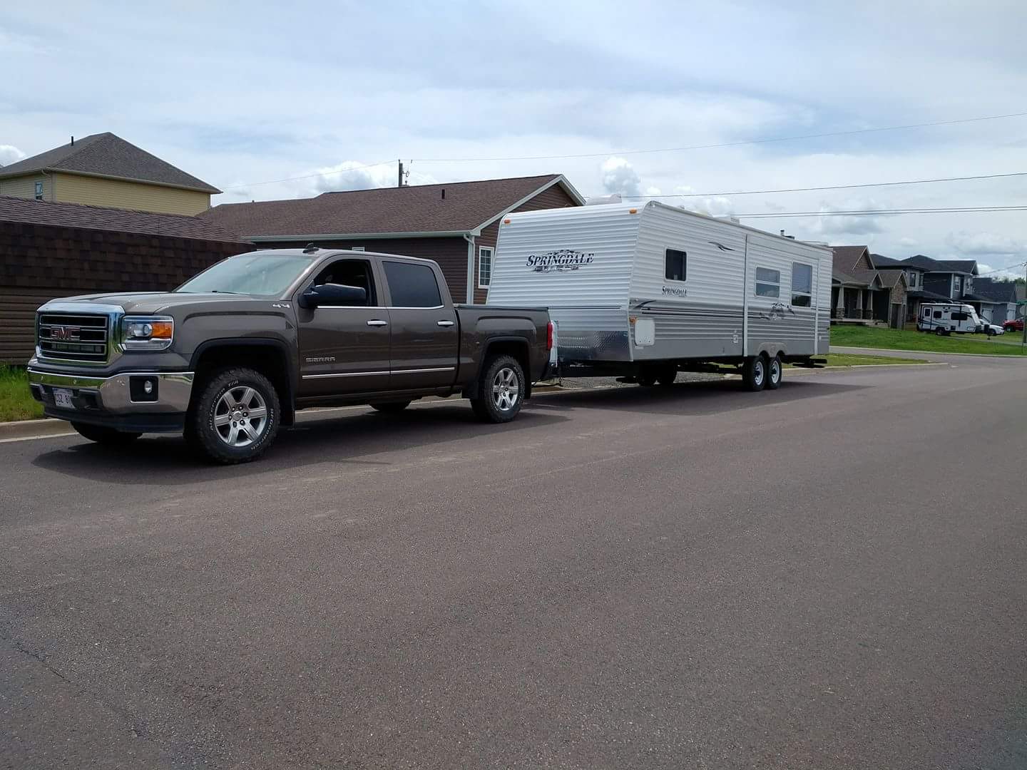

I tow a 32' camping trailer. I'm always worried at the scales because the maximum combined weight GCWR of 15,000lbs. Trailer is 6,700lbs empty and truck is probably close to 6,500lbs. That just leaves 1,800lbs for passengers, all the gear, food, water, etc. I added Timbrens in the back and have 10 ply tires with 75lbs of air in them when towing. It tows good but wouldn't want to go longer/heavier on a half ton truck,
