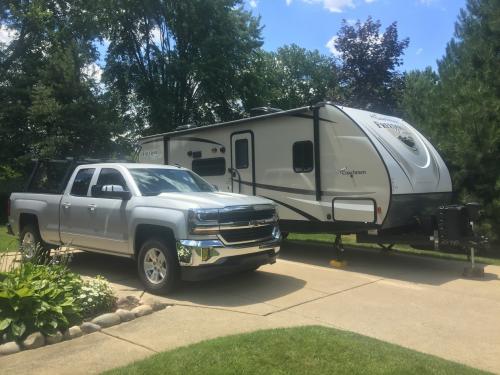

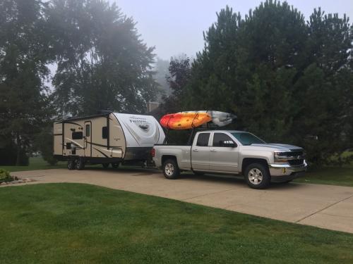

I am 27ft, ~6200lbs loaded on trailer.
5.3L with 6 Speed, 100% stock.
Truck does just fine towing this, I do wish I had air bags to help out a bit more and I am adding 'shocks' to the trailer as well to help on the bounce.
Other than some suspension dislikes my truck does just fine....
Towing weight 8800-9000
Not just local, NY to Fla. twice yearly
Truck is a towing beast.
Avg over 11 MPG
2017 6.2 max tow
