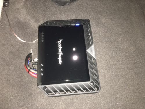

Added Sub and Amp
This is the start of making this truck sound right. I have the Bose system but a jump seat so the subs were in the doors, horrible idea, so now I diverted the bass to a sub under the back seat, it's a Rockford Fosgate 10"(I have a grill coming, it needs a low profile one) with a RF 500 watt one channel one ohm amp. It made a world of difference, now it sounds great and all the songs with really low bass can be heard. It is amazing how a good sub with lots of power sent to it can really wake this up. We installed a volume knob which is really nice for adjusting based on different music. Very worth doing, even if you have the console with the sub in it, going this route will improve it in a huge way.
care to share the box, sub, and amp model numbers?
I've been wanting to add a sub to mine and this setup looks about perfect.
The amp is a T500 Rockford Fosgate.  The sub is a RF P3.  I didn't install it so not sure of the wiring, now that I have had time to play with it I am very happy, it made a huge difference.
