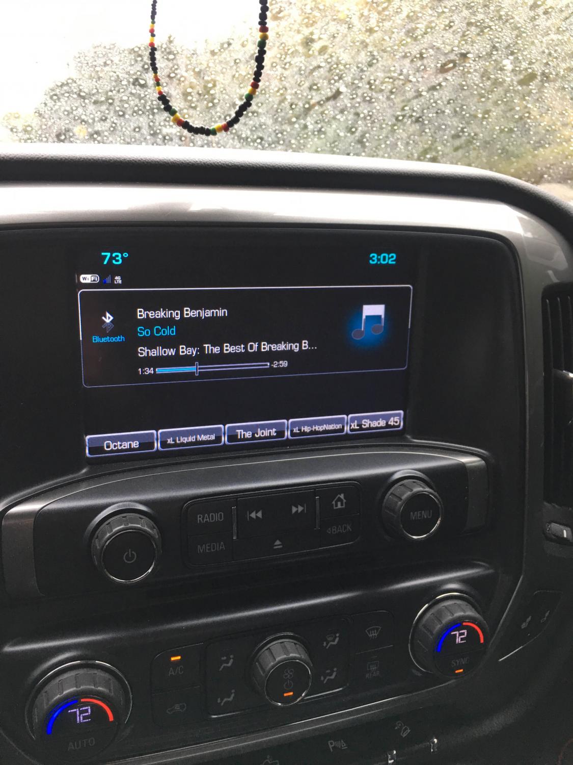

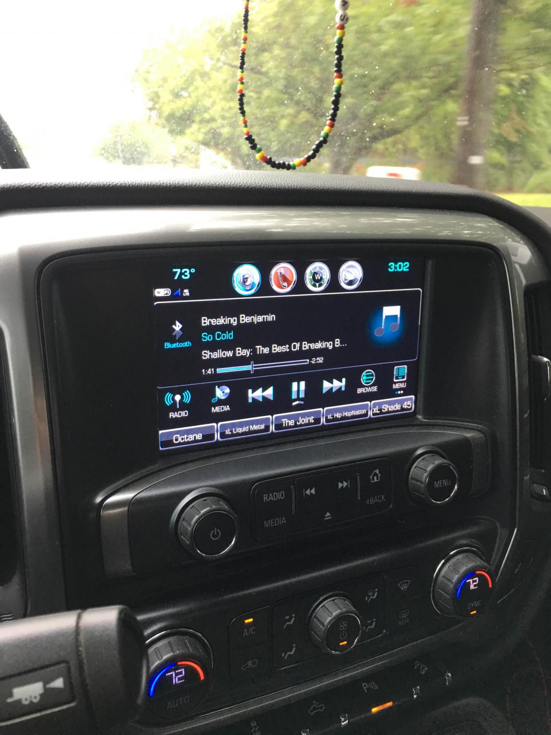

on my 2017 1500 crew cab lt Im having this weird issue where when listening to anything on the 8" screen the play, menu, skip and all of the disappear like an autohide or something. Then when you touch the screen they all pop back up and will hide again.
Here are some pics.

So after trying my different things.  I tried not connecting my phone and I thought that fixed it, but that wasnt it. HERE IS WHAT IVE FIGURED OUT, please try this guys and tell me if you have the same results.
If i get out of the truck and leave it on lets say OCTANE radio, lock the truck and leave it and go have lunch lets say.  If I get back into the truck start it up and not touch the screen at all it dosent happen.  I can adjust the volume up and down with the wheel or the knob and it still dosent do it.  AS SOON AS I TOUCH THE SCREEN wether it be changing favorite or media then it happens spot on like 1 minute afterwards.  this is the only thing I've found to trigger it.
