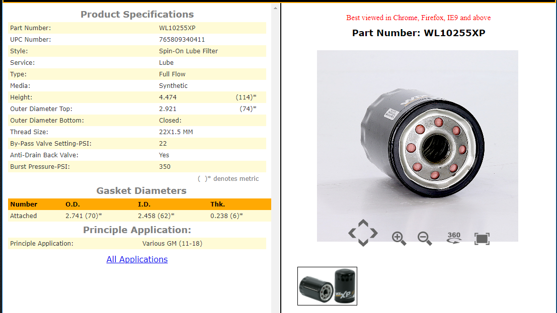

I think I put a PF-63 on my 2014 last change.  My concern with them is I believe they may not be a high mileage/synthetic media.  I recall seeing some filters where the media was coming apart at moderate mileage, well under my intervals.
I like the idea of going to the 57045xp for synthetic.  (Running M1)
  • 5 months later...
For those interested or who reply'd to this message WIX has now updated their filter to meet the revised spec's.  They no longer spec a 57045xp but rather a 10255xp.
The Napa Gold part number for this filter is FIL 100255...I installed one on my 2015 Sierra 5.3L yesterday. The local Napa store got the area manager to pick one up at another store and drop it off at the warehouse. The warehouse shipped it to my local store, but they're supposed to get their own stock in a week or two. I've heard that Fram is going to be changing the XG 10575 bypass valve to 22 psi, and if/when that happens I'll go back to the Ultra.
