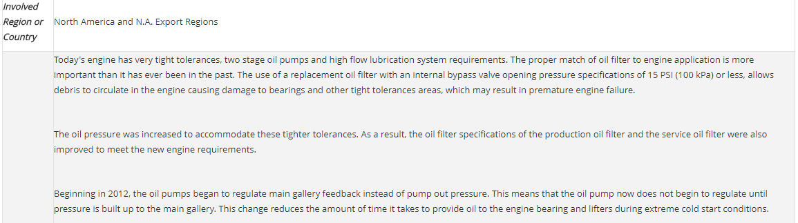

dbrobins27 Posted November 1, 2017 Posted November 1, 2017 Hi All, After using up my dealer provided oil changes, I am ready to take on the tasks myself. I have read lots of info on people disliking the PF63E due to the construction of it, but it seems that besides having some material changed, it also has a pressure relief change to 22psi from 15psi. I have always liked WIX filters so I ordered a few 57045XP as those are listed as a cross reference for PF63E. In doing a little more research and making sure I had a good quality filter, i found a reference document that stated due to the oil pump design, a filter with less than 15psi bypass pressure shouldnt be used. So my dilemma is: Should i just use the PF63e? Will the Wix 57045xp be acceptable although they list the pressure as 12-15psi? A Wix 57502xp meets the pressure requirement of 22psi, but doesnt show as a cross reference for PF63E. It does cross reference a Hastings LF461 or Baldwin B7449 which show as being direct replacements for our trucks. Although the 57502xp meets the spec's it doesnt show as a PF63e replacement? Would you use anyway? Lots of conflicting info out there and I just want to make sure I have the proper filter on there. Thanks for your advice!

dbrobins27 Posted November 2, 2017 Author Posted November 2, 2017 14 hours ago, 2017SierraSLT said: To muddy the waters a bit, the factory installed filter is not a PF-63E, It is just a normal original design PF-63. If you look hard enough, they can be found. Thats the confusing part. The factory installed filter is PF-63, The service filter that GM recommends is PF-63E. PF-63E has the different bypass pressure specs. So most of the parts providers recommend a filter that is comparable or equal to the PF-63. There are a couple out there that based on the model year and engine specify a filter with the revised bypass pressure spec. Here is a bulletin or document I found: http://www.corvetteactioncenter.com/tech/knowledgebase/article/2012-2017-corvette-service-bulletin-17-na-157-information-on-spin-on-oil-filter-replacement-for-gas-engines-designed-with-new-oil-pump-control-systems-1363.html I have an email into wix to see what they have to say about the 57045 not meeting the pressure specs of the PF-63E.

dbrobins27 Posted November 8, 2017 Author Posted November 8, 2017 14 hours ago, Grumpy Bear said: The filter is downstream of the pump and the pump is of internal bypass design. The filter bypass is an internal feature of the filter proper and is there to assure oil goes where it's suppose to when the oil is cold or the filter is plugged. Has nothing to do with the pump, it's design features or requirements. The bypass pressure is the pressure difference across the filter media irrespective of the filters inlet pressure (pump discharge pressure). Thanks for your insight. I suppose my original post was more or less quoting the bulletin below that oil pressures had been increased, therefore filter specs were also improved. Perhaps my wording of oil pump design wasn't appropriate. Regardless to update those that are interested, the folks at WIX did call me and said they are looking into the information and they will get me a formal response soon.

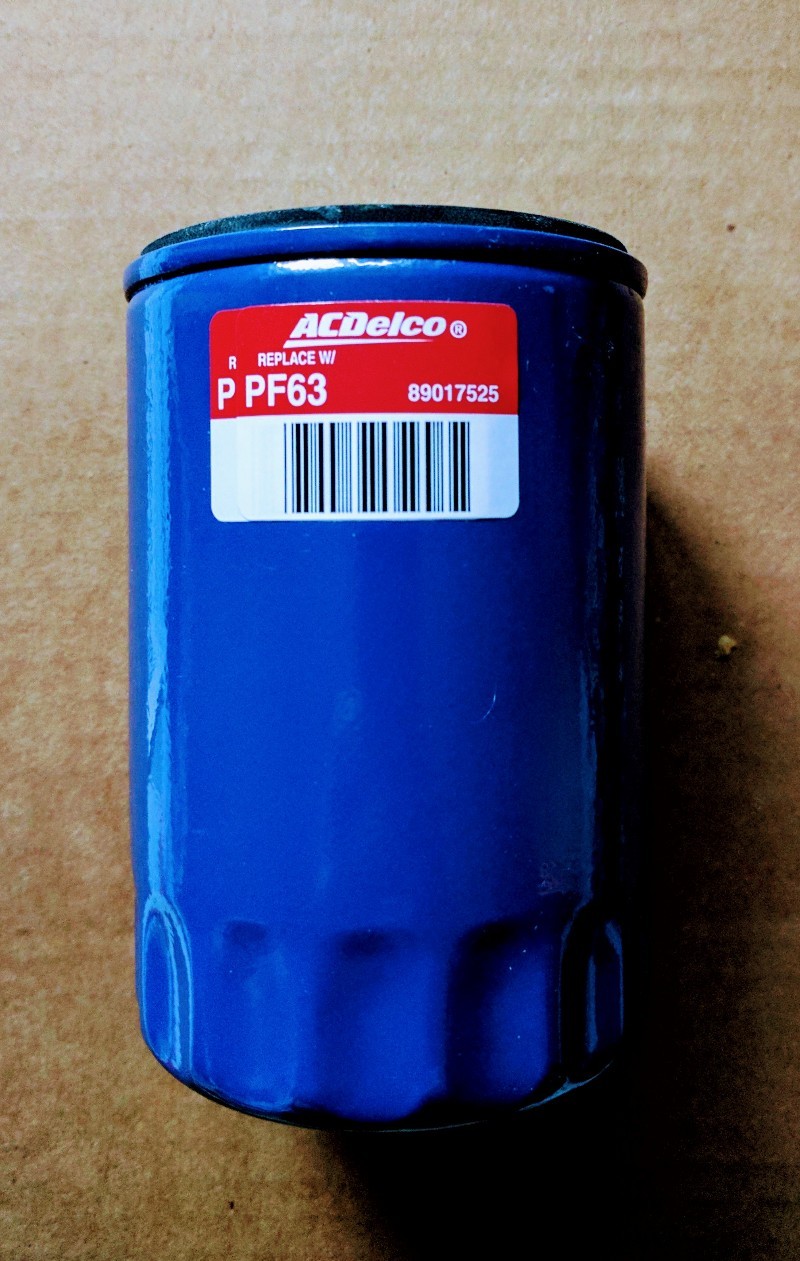

Crobinson16 Posted November 8, 2017 Posted November 8, 2017 For what it's worth, my new 2017 5.3 build date of 7 - 17 came from factory with the straight pf63 part # 89017525. I have looked at 4 new 17s and they all have the older version filter with the older part number. I have tried just about everywhere to find that part number pf63. If they were truly worried about the pressures and the new filter specs they would not use the older version.
dbrobins27 Posted November 8, 2017 Author Posted November 8, 2017 1 hour ago, Crobinson16 said: For what it's worth, my new 2017 5.3 build date of 7 - 17 came from factory with the straight pf63 part # 89017525. I have looked at 4 new 17s and they all have the older version filter with the older part number. I have tried just about everywhere to find that part number pf63. If they were truly worried about the pressures and the new filter specs they would not use the older version. Thanks for the info, that is interesting.
2017SierraSLT Posted November 9, 2017 Posted November 9, 2017 17 hours ago, Crobinson16 said: For what it's worth, my new 2017 5.3 build date of 7 - 17 came from factory with the straight pf63 part # 89017525. I have looked at 4 new 17s and they all have the older version filter with the older part number. I have tried just about everywhere to find that part number pf63. If they were truly worried about the pressures and the new filter specs they would not use the older version. Here are cases and cases of them. With free shipping they are $3.59 each. https://www.ebay.com/itm/Engine-Oil-Filter-Durapack-ACDELCO-Pro-PF63F-Case-of-12/172925950178?ssPageName=STRK%3AMEBIDX%3AIT&_trksid=p2060353.m1438.l2649
Crobinson16 Posted November 9, 2017 Posted November 9, 2017 Sweet, not sure how I missed them on eBay. Thanks
