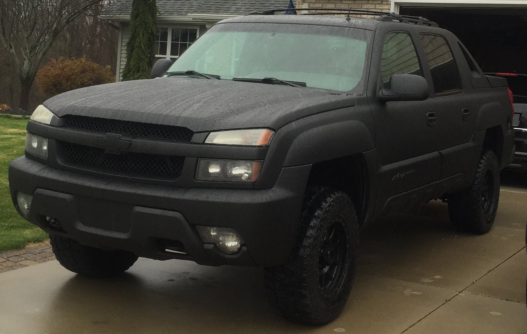

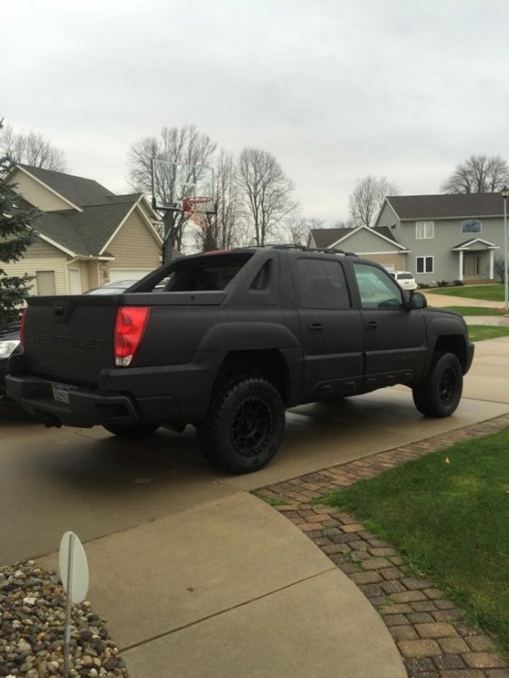

Yeah. I am with you.  I cannot justify a truck payment that will put me into economic slavery for 10 years. For now it is Mad Max apocalypse time.  I will keep fixing up the old one like i live in a third world country.
