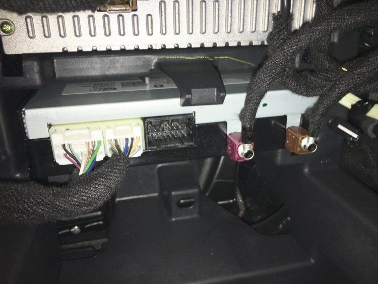

Hi Krunch,
Yes, I got this all squared away. What I did with my truck is that I researched accessing the radio and was able to get direction to open up the trim around the center display panel... after some nervousness because, after all, this was a brand new truck!  I found that when I removed the display panel, I could easily access the wire to the "shark fin".  I bought a simple antenna wire extension to fit both the back of my Onyx radio and to connect to the shark fin behind the display panel.  Not sure where I bought it, but it was an "internet search" find... maybe something to do with "XM radio antenna extension"... probably 20 inches long... male/female wire.  It is a very simple job to snake the wire from behind the display panel to the accessory plug area below.
Next, I wanted to make my accessory plug (bottom center dash) to power on only with key. (Mine was live all the time... not what I wanted) I tapped the fuse box by driver's door, ran a power wire under the dash over to the accessory outlet area.  I then bought one of those XM radio "plug in" power mounts to plug into the accessory outlet.  Once I mounted my Onyx radio to the plug in mount and plugged in the antenna pigtail (from the shark fin) to the back of the Onyx radio... turn on the ignition and IT WORKS!
It has been over a year now with absolutely no issue.  I was initially concerned that the plug-in mount might be flimsy (because the accessory outlet really is not built to support any real weight)... but no issues so far!

I got the dash apart, I see 2 Sirius looking antenna plugs, one is brown and one is purple. Is it the purple one?

upper right hand corner... pull the cable and the plug is tan (on mine anyway) .... see photos further down in original post.
Hmmm, I have purple and brown. See below.

Not sure if you are still waiting for me... but when I did it, I pulled the plug and turned on the old xm... if no signal connection, it says it and you know you have the right one! Your pic looks different from mine. Mine was exactly like the one pic I put in the post.
Yeah, I have no stock XM radio, only OnStar. I pulled both out and OnStar still appeared to be working. I will keep looking and maybe post something new that maybe a GM tech or someone with access to GMSI can help.
