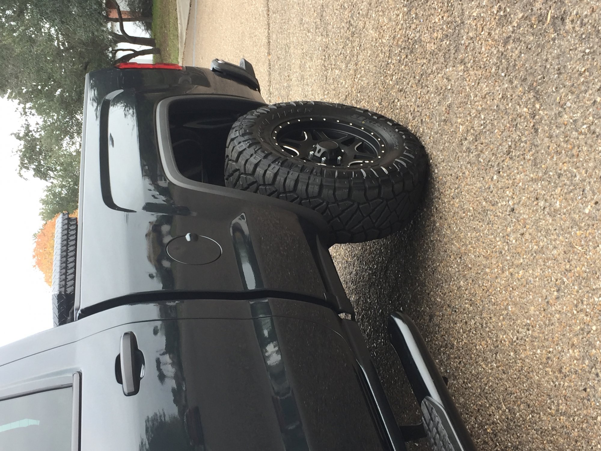

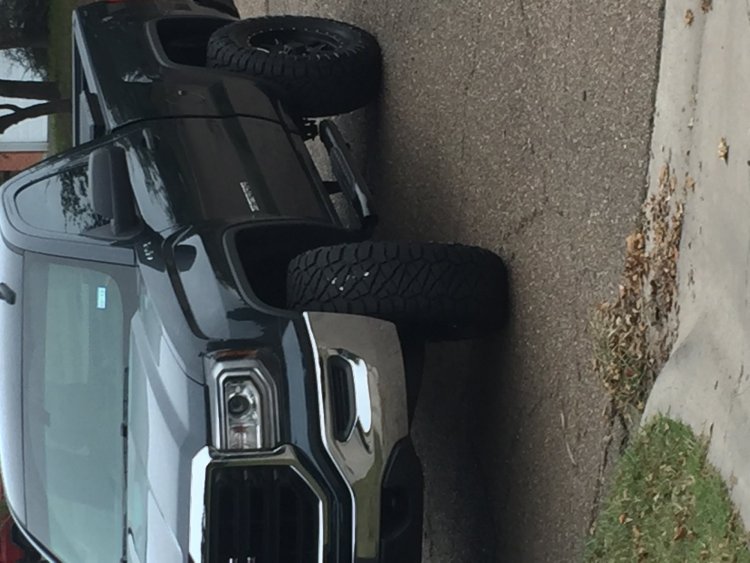

I'm looking for wheel and tire ideas for my 14 LTZ Z71. I'm thinking a 285/65/18 with a -12mm offset. please post pics if you have something similar.

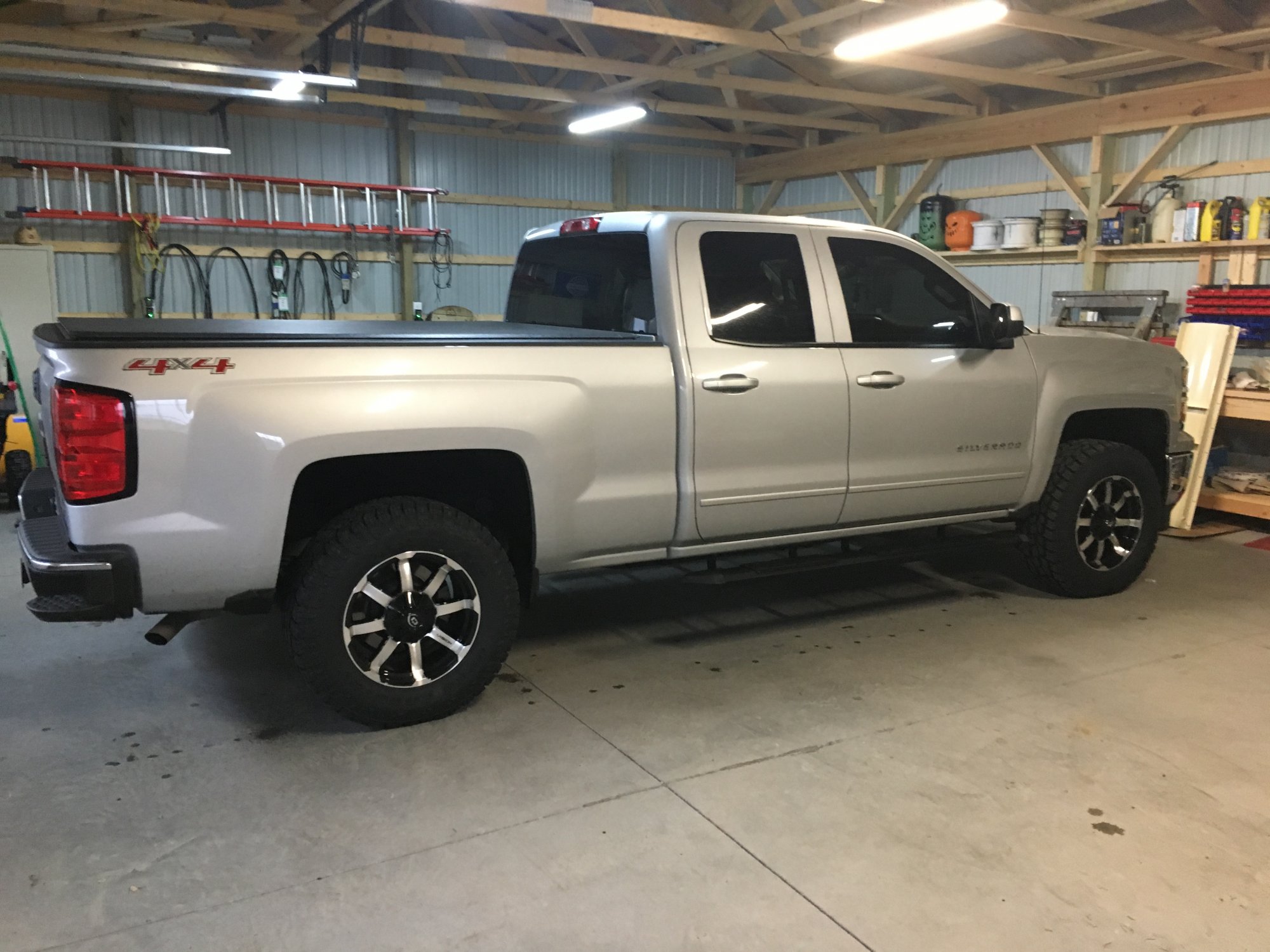

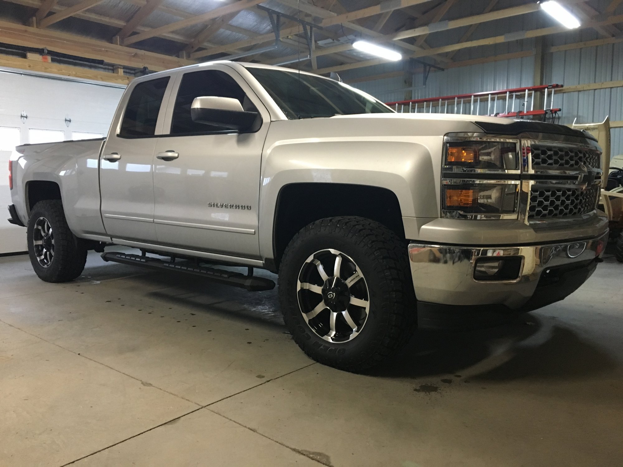

These are 285/65/18 on 18x9 with a +12 offset. Truck has a 2” leveling kit.  With -12 wheels, the tires would stick out another 24mm which is almost 1”(25.4mm).
I was hoping to see a normal leveller.. I am installing a 2 inch on my dads 2016.
that looks just right.
4 hours ago, Grind383 said:
That looks really good. Any rubbing issues?
Thanks. No rubbing. The tires were about 1/4”  from the fender liners so I zip tied them back to be safe.

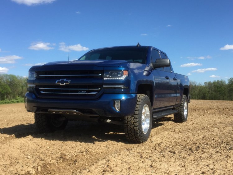

I have a 2017 Sierra with a 3 inch level front and back, which was installed by the GM dealer before I took ownership... I’m running 35/12.50/18’s with a positive wheel offset , the discount tire crew were surprised by he no rubbing fitment.. now yes once I start to flex it’s going to rub...a NorCal mod will fix that issue ..
