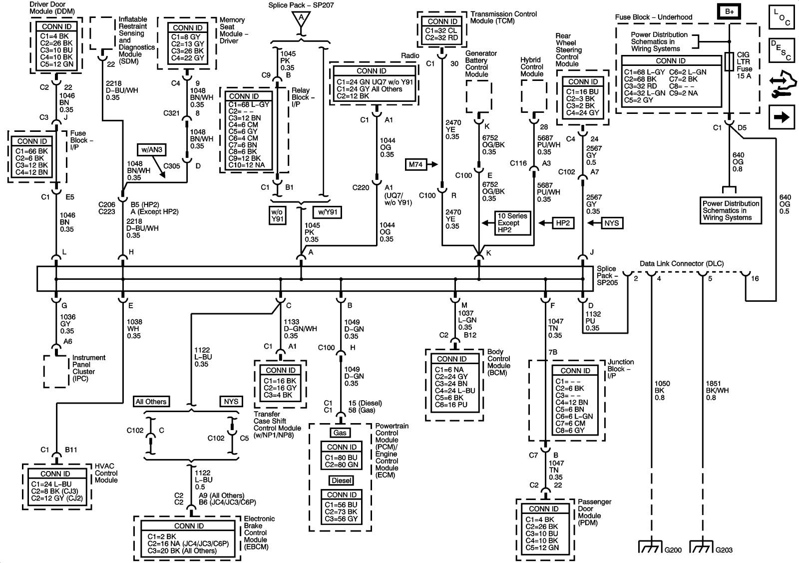

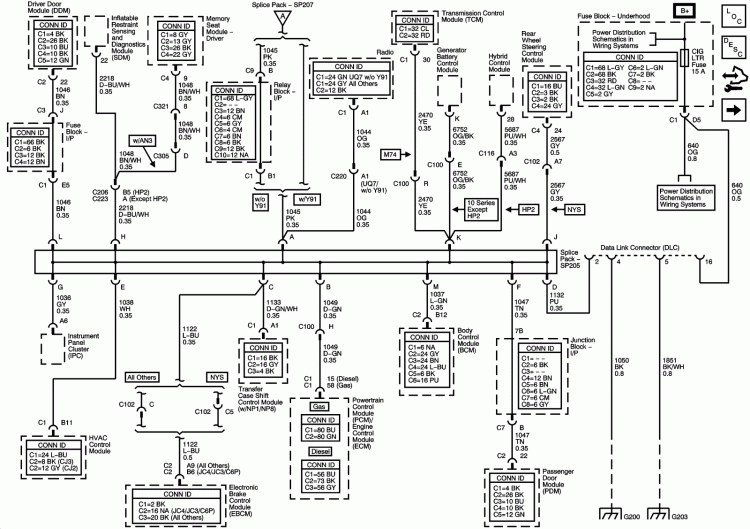

Remove Connector 1 (BLUE) from the ECM. Goto Terminal #58 (dark green) and using a multimeter check the resistance from Terminal 2 (purple) of the DLC (Data link connector where you plug your scan tool in) And let me know what the resistance value is. I will help you walk through this if you want.
Here is a schematic to help.
