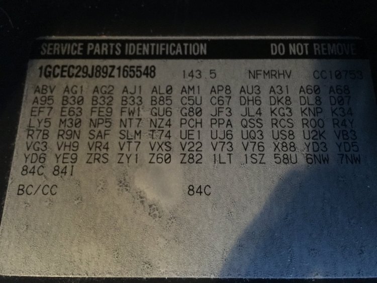

I'm having a tough time finding touch up paint for my 2009 Silverado.  My glove box sticker  says BC/CC 84c,  and my original window sticker say Black granite metallic.
However all the Googling I do comes up with nothing regarding 84c!  Can't even find it in cross match sites, though Carbon Flash "seems like it may be the same thing"...
I thought this would be straight forward....ugh.  Thoughts?
The paint code can start with BC/CC followed by a U, or a WA with a four-digit number/letter combination.  Are the more numbers on the spid label.
Paint names are marketing so they don't always show up in paint lookups because the name varies by GM division, Chevrolet and GMC may not be same name for to color.
Its probably just Black;  http://www.genuinegmparts.com/collision-auto-body-parts/auto-paint-touch-up

Just give the dealer your VIN - they can figure it out from that.
Do you have 41U in the RPO list?  That's my 2009 Yukon's code for Onyx Black.  There was also a Carbon Black Metallic (58U).  Chevrolet called this same color Black Granite Metallic (58U) in 2009.  It was an extra cost color.
