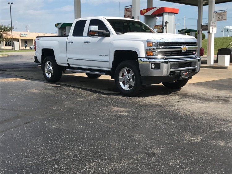

All I did was turn up my bars with the factory keys to level the front end. I also have bags in the back, and with 5-10 psi in them, it adds about an 1" to the rear.
I run 305-75-18 tires on factory 18" wheels and only have slight rubbing on the frame at full lock. 992c90aebad1aaa278f8a3d115967025.jpgdba9b87aae0266388c182fe2efaca254.jpgd93f4d6683670e82cecbb7cca24cc251.jpg

Nope. I ran 35/12.50 BFG Mud Terrain with no rubbing, and now these 305-75's with just a little rub on the frame at full lock. This is with the factory 18" wheels and just cranking the factory keys for a level.

The more I look at your truck the more I love it. What exactly did you do to the front and rear? Brands you used? ride quality?

In the front I just turned up the torsion bars with the factory keys, that got me pretty much 2" of lift in the front. In the rear I have a set of Firestone air bags for towing. When I'm empty or not towing I have about 5-10 psi of air in the bags just so they don't get ruined. That puts the rear around a 1" of lift.
The ride is the same or better than stock.
I really love this truck, it's in my top three out of the 7 I've owned in my life.
