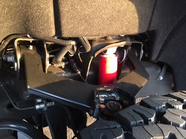

Just had a ReadyLift level kit installed. I have a 2016 2500 with Nitto Terra Grappler G2 275/65/20 on 20x9 Grid GD1 +15mm offset.
Did you change the upper control arms? Mine only have about 1/4" before hitting the stops. There are signs that they are hitting. The measurements the installer gave from before and after show almost 2.5" raised to level. Steering also seems a little loose.
