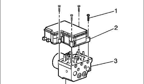

Hi, You're probably on the right path with the EBCM. It is mounted on top of the Brake pressure Modulator Valve (BPMV) and is going to be one HELL of a job if it is rusted. I am going to list out the codes for you and go on it from there.
ALL THE ABOVE ARE - C0241-C0254 or C041-C054 EBCM Control Valve Circuits
C0265 C0266 EBCM Relay Circuit
the problem si going to be removing the Torx bolts from the top of the EBCM. Thet are T15 bolts. Here is what I would recommend.
Use a pick tool to clean out the top parts of the bolts. Use a can of Air or shop air if you got it to blow out the debris.
I would be very careful. If it feels like they are going to stip stop and use a hammer and tap the sides where the bolts go.
If they do strip, Split the side of the EBCM (you won't be able to exchange it or have it repaired) and remove the ebcm and then remove the bolts.
The biggest thing is you don't want to mess up the BPMV. If you do... look forward to replacing a lot of brake lines and multiple migraines.
I know the EBCM is expensive... But between the EBCM and the rusted BPMV and brake lines that have pretty much welded themselves to it... I would rather pay for the EBCM than pay for and fight the BPMV.

Yeah you don't have enough room. So what you do is use a Torx bit set (don't get a tamper proof set because it will flex) and a mini ratchet. Or use a 1/4 6 point wrench on the torx bit.

Ok thanks for the heads up. I might have to just have my brother take it in to his shop where he can put it on a lift. Is the ABS pump located inside the EBCM?
Oh ok, thank you for the clarification. So I guess my plan will be to first repair the EBCM and go from there. It'll take awhile since I'm away and can't get to my brother's shop, so thanks for the help everyone! If anyone has anymore advice or knowledge, please let me know, I've been troubleshooting this for awhile.
