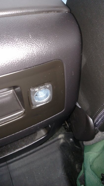

Fixing cover on charge port on back of center console
Today my kids snapped off and broke the cover of the rear charging port on the back of the center console.
Any way to fix this?

Got the cover replaced.  Used this video as a guide for removing the back of the center console:
Then it's just a matter of popping the cigarette/power outlet out from the rear. Once out, the power outlet cover just snaps on/off over the power outlet. Then just snap everything back together.  Pretty simple.
1 hour ago, BigBadSierra said:
It's a cheap part but allot of work to change it.
Not really, I thought it was pretty simple and only took about 10 minutes
