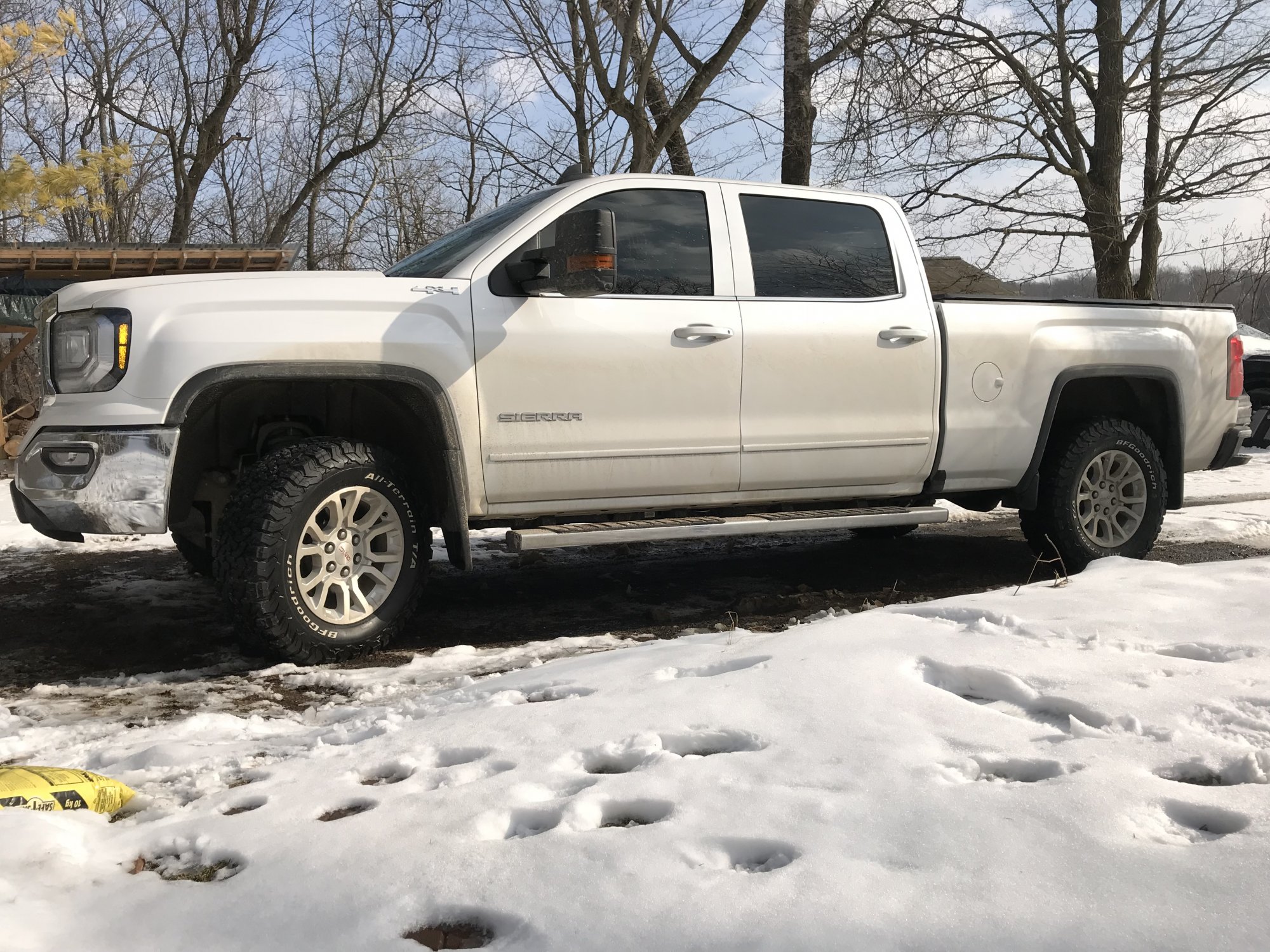

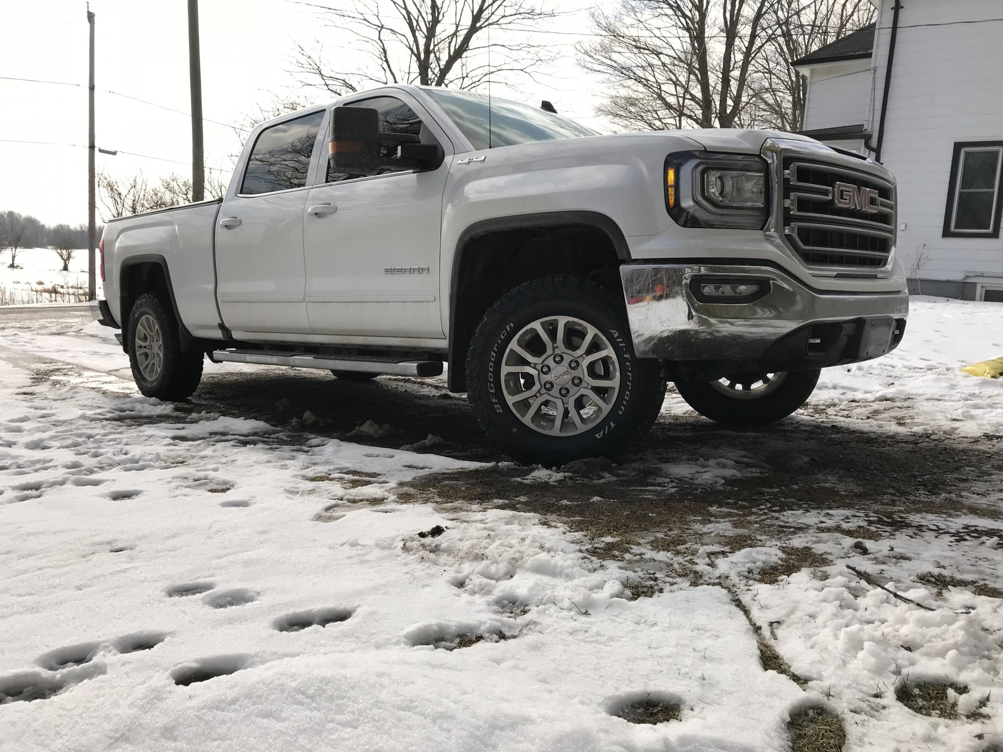

Yes sir. 2018 GMC Sierra with 2.5 inch level kit, 285 /65 / R18 tires
Ride's like stock, maybe better. Looks way better. I took the air dam off which really helps the look as well. I put bigger tires on too. I highly recommend it.
