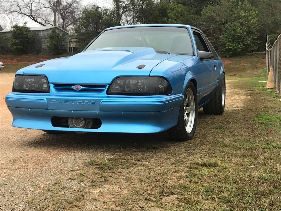

sorry, I forgot that part. not sure on weight but I use it once a month or so to pull a 22' enclosed trailer to the race track. with stock wheels it was asking a lot, but with the new wheels I can feel it struggle more without the trailer. a 3.42 would prob get buy but id rather have a little more grunt and worry less about fuel economy with the 3.73. I will wind up doing the front gear eventualy but for now id like to just do the rear. if I knew I could pull the shaft or just not put it in 4wd I would but not sure of any negative effects it would have if any in the mean time.
pic of said racecar...
