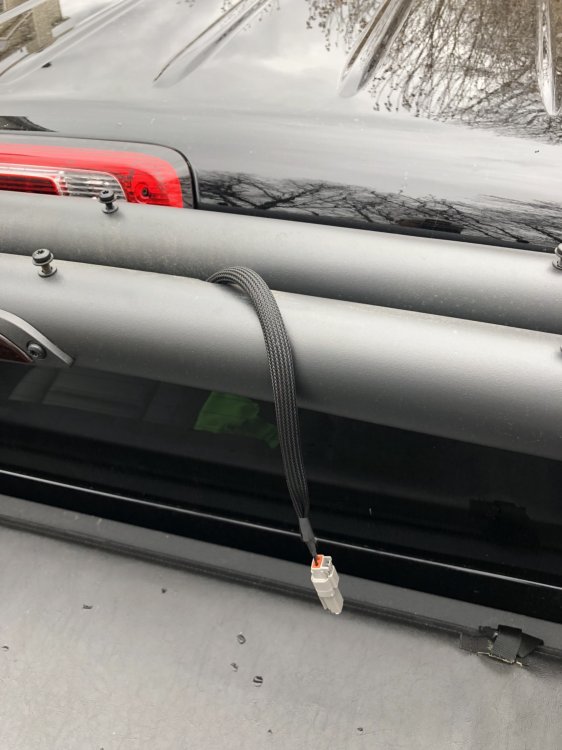

I was installing 2 8” RC light bars on my 2017 Sierra all terrain x’s roll bar and noticed a harness was inside the bull bar. Anyone know what that harness goes to? Is it connected to a fuse? Any help is appreciated. IMG_9626.thumb.JPG.523f7bab54d247d91781bf1f1c738c7c.JPG
For the factory/dealer lights I believe.57F67240-8779-4D7D-BB58-2C4B65264F43.jpeg.346b3221b384b6b0c0ce047f24f7806e.jpeg
That’s what I figured so it must be ran to a fuse box. I believe if it comes from factory there’s an accessory light button below/on top of the fog light switch which I obv don’t have. If I can find the fuse I’ll buy the factory acc lighting switch and put that in.

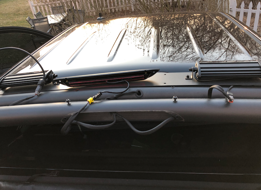

So an update... I took off the 3rd brake light and found there were 2 light connectors already wired. I followed the loom to the engine compartment and found where it connects (pic 2). The loom originally had a blk, purple and brown. After the connector there was only blk and purple. The blk was grounded and the purple had a line added to it.. 1 of which went to the fuse box and the other was not connected and just zip tied (pic3). How do i get power to the lights... ps the lights do not turn on when brake is depressed. (Ill add pics on next post since ive been maxed out on space)5ac01b8f1a519_ScreenShot2018-03-31at7_35_27PM.thumb.png.708e683953d555732b13b3da9095182e.png
