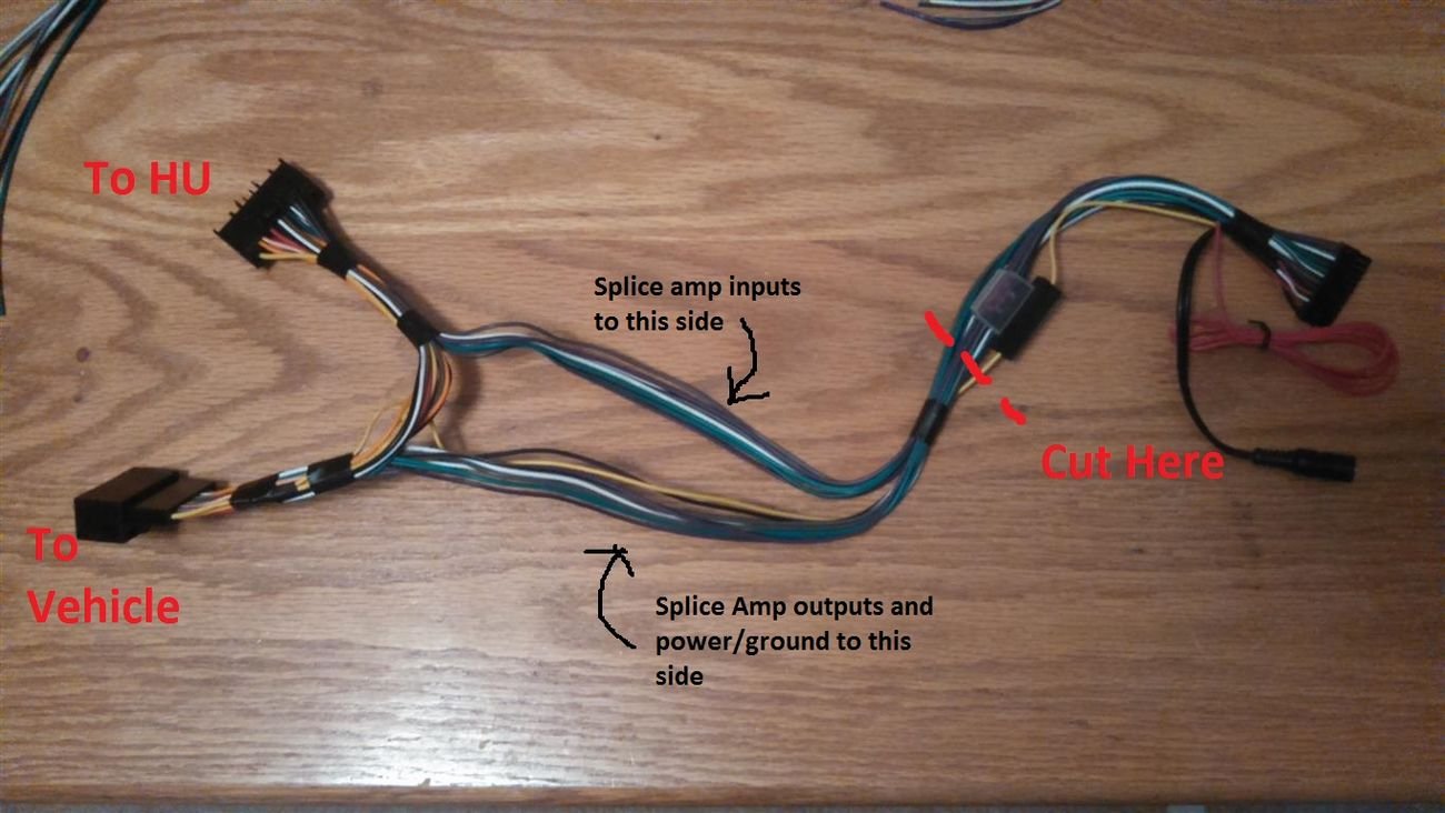

For those of you that are that are looking to install an aftermarket amplifier to your factory stereo but DO NOT WANT TO CUT YOUR FACTORY WIRING HARNESS, then the harness you can use to easily modify so it's a plug and play solution is the GM-5MKi, it fits the following vehicles.
There is lots of information and images on how to easily install an aftermarket amplifier on the F-150 forums which would be the same as when it comes to modifying the wiring harness so it's plug and play.
https://www.f150forum.com/f118/so-you-want-install-aftermarket-amp-313994/index2/
