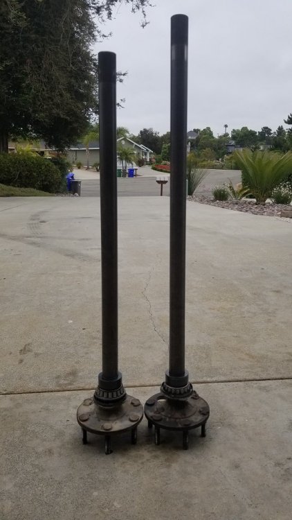

So here we are 4 months later..... Took it out to Parker AZ and ran a good portion of the Parker 425 course. Was on a left hand sweeper, going about 65-70 mph, and chose a right line that ended up with a 3 ft drop off. Apparently F**d 9" semi floating trussed axles are not meant to take all the weight of a crew cab on 37's being thrown off a 3 ft drop at 65-70 mph. Bent both axles, blew out the bearings and twisted the housing. :(
Sent the axles and housing to Currie to check it out and they confirmed what I thought. I roasted the rear end. :shock:
So I took out the 3rd member and put in an order for a 4" full floating housing. :D No more busted axles!
