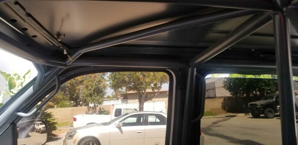

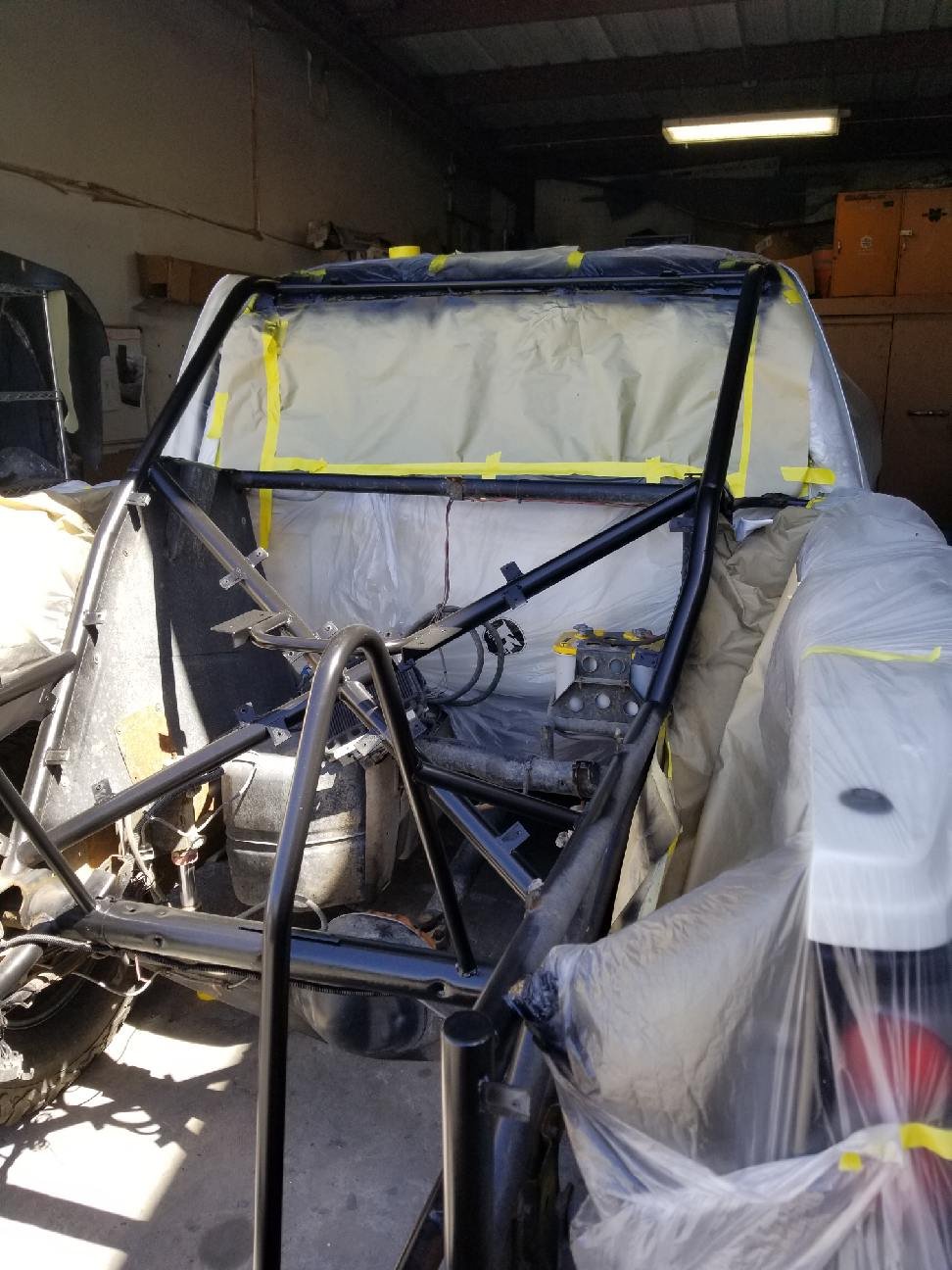

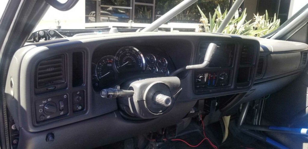

So there was a bit of miscommunication and the truck had to go back in and get painted a third time.  Fab guy thought I was going to do a headliner and I'm putting that off until I handle other things that I find more valuable like 4 linking etc...  So the truck had to go back in and get the ceiling and side down cross beams painted also.   That got finished up and the truck is now back at the shop getting ready for the next phase of work.  The dash is pretty much back together now too.  Time to rock and roll and knock out the last dozen or so things.

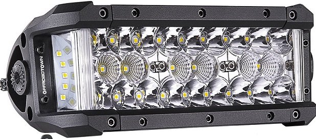

Couple 7.5 inch cheap LED side lights on each side of the roof rack.  Will be nice when were out chasing or setting up camp late at night.  Connect them to their own independent rocker switches.
Read some good things about these if you pull the front lens off and reinforce the seal.  We'll see.  Worth a shot for the price.

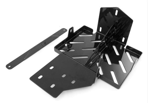

So I've been punching some #'s and I have come across the realization that I am going to be under powered if I am going to run all these gauges and lights. I have 1 yellow top back up battery in the bed so going to double up with another 830 cold cranking amp yellow top Optima battery. That should give me enough juice to run everything. Have to swap out the battery tray etc...
It never ends.... :lol:

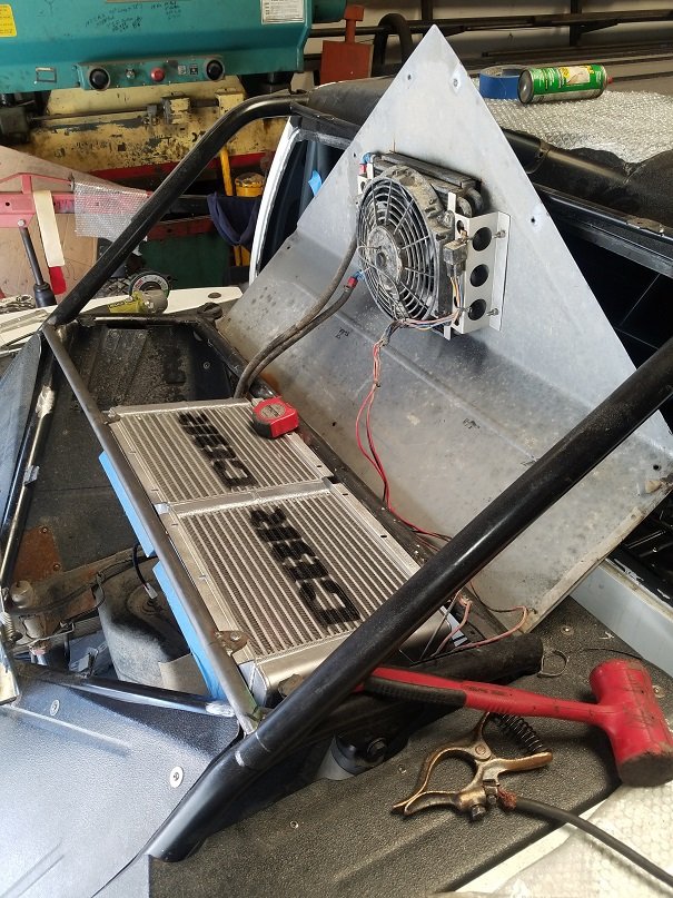

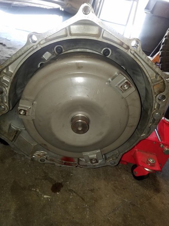

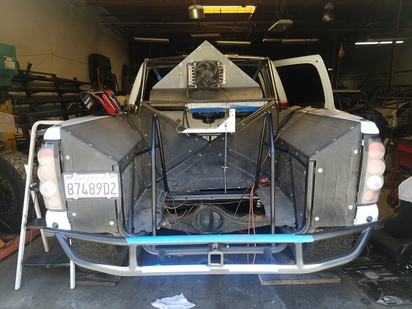

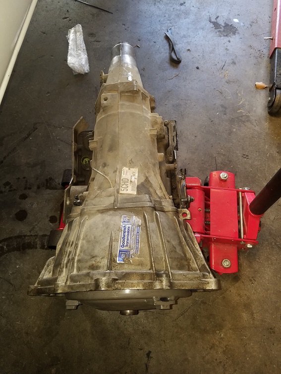

Out with the old... New Culhane racing dez prepped 4L80E delivered next week.
Dual CBR Trans coolers installed. Oil cooler goes in the 3rd slot soon. New sheet metal will be cut to form around the coolers to allow air flow.
The old cheap cooler is the one still bolted to the sheet metal.
Custom jack holder mounted for my pro eagle 2 ton jack. I put it in the middle so its tough for thieves to reach it but it's still easy for me to get it since I am 6'7. Plus it will be partially hidden behind the spare tires.
