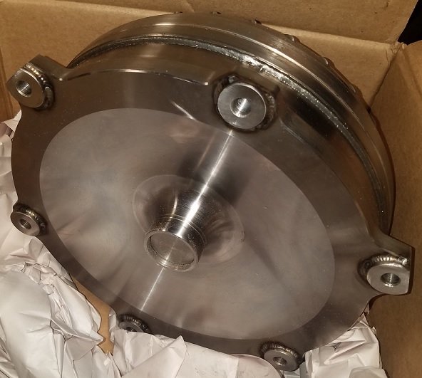

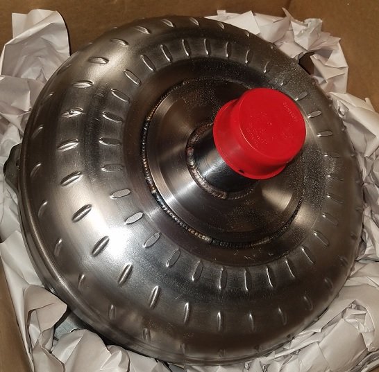

The TCS Billet 2,400-2,600 Torque Converter arrived. We downsized to 9" since we put the dual trans coolers on there. The 9" will generate a bit more heat but going down an inch will give me a bit more pop.
Damn it's pretty... Almost feel bad beating this thing up.
Sort of. Maybe not...

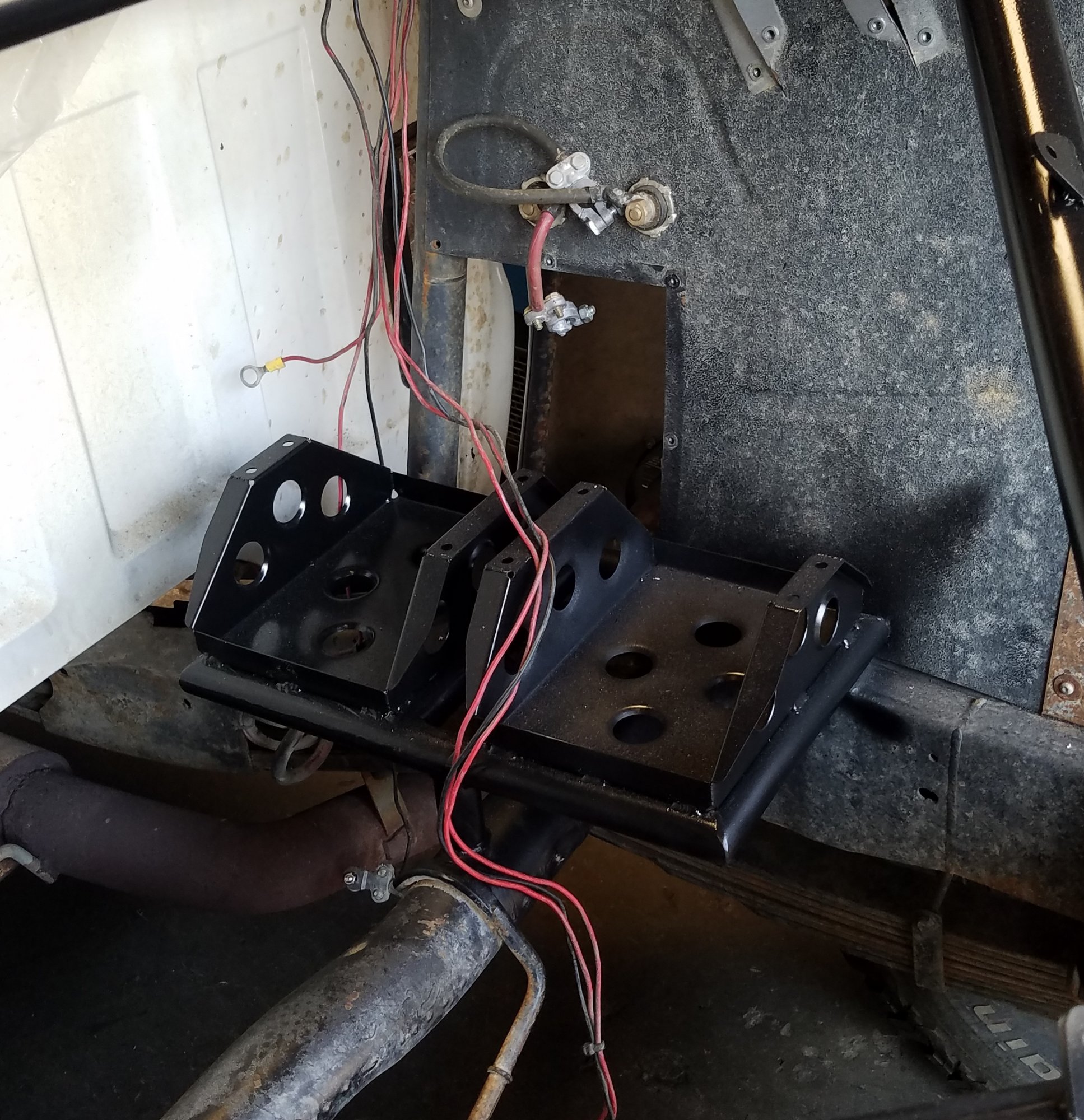

Got down to the shop to see how things are going and to drop off the last few things.

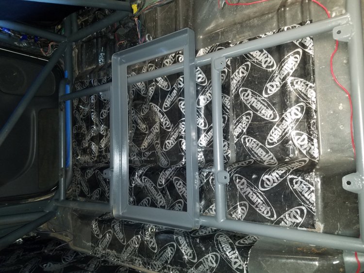

They got the fridge rack in. Very important!

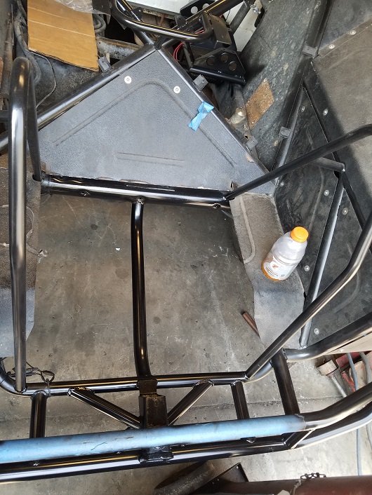

Got the rear tubing reinforced several ways so I feel confident hauling a trailer or for putting my motorcycle rack on there to haul my XR650R.

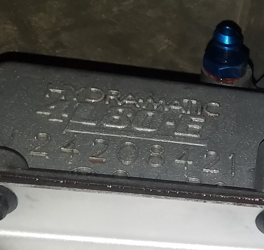

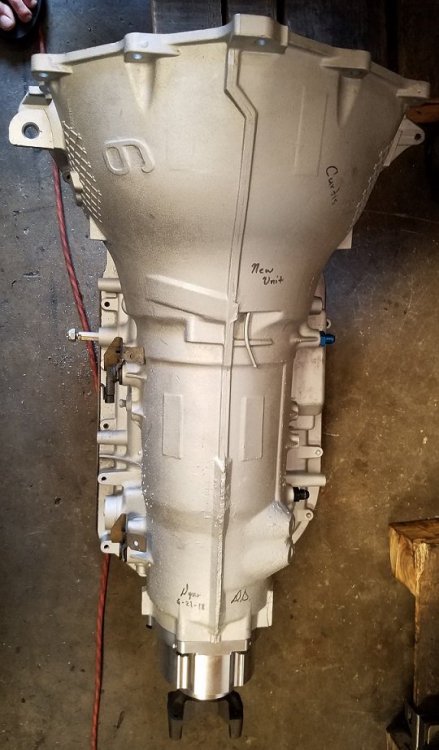

My Culhane dez prepped 4L80E transmisson with billet extension housing and bolt on yoke.
It's so pretty.... I can't wait put this to the test.

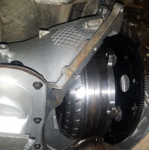

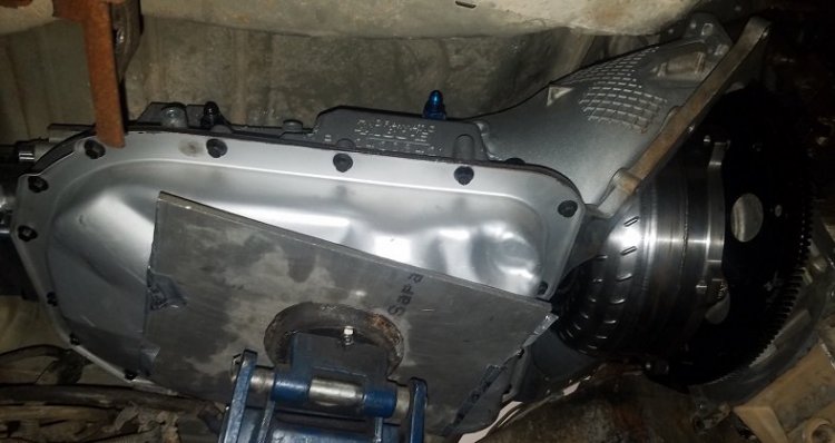

And...... It's almost in! It looks so nice with the TCS torque converter and ATI flex plate
