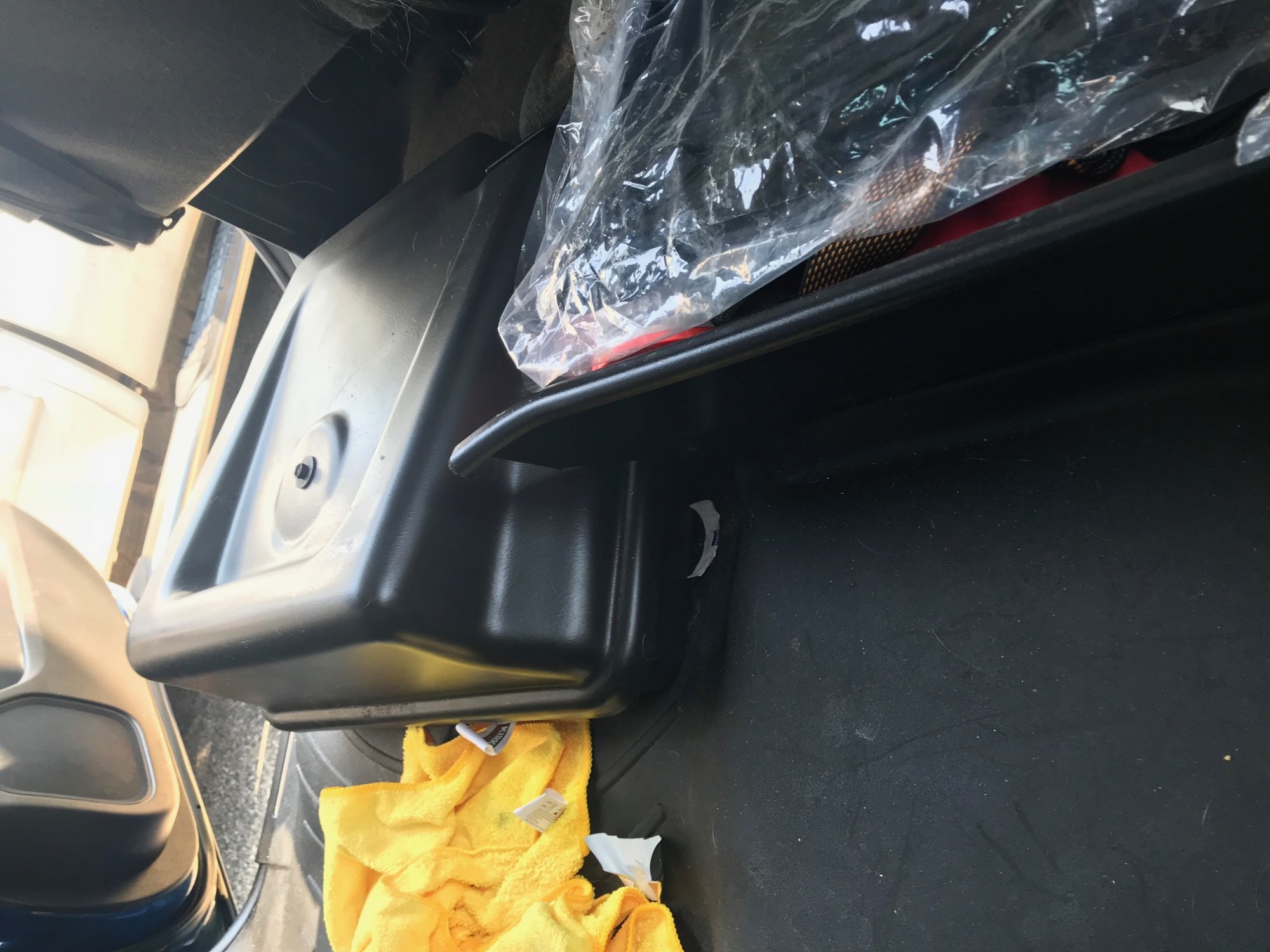

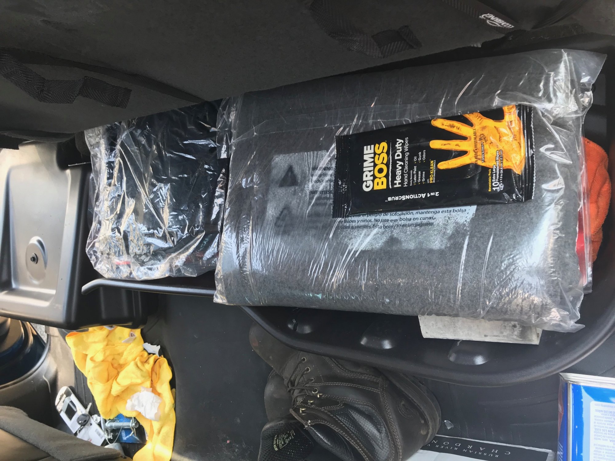

Regarding the rear seat space, I have the GM underseat storage.   I trimmed the storage so it meets with the sub pretty cleanly and I still have almost 2/3 of the storage space.  I can try to take a pic if you are interested.
would love a pic!  did you disconnect the factory Bose sub?
  • Replies 43
Did not disconnect the Bose sub yet.  I am thinking about testing it with and without it.
Here are a couple pics.

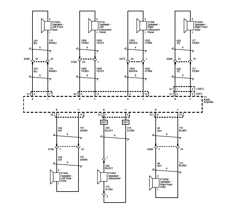

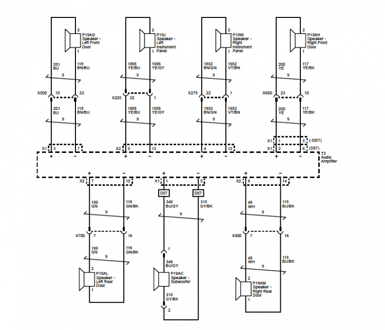

I'm now making plans to upgrade the sub, putting a powered one under the rear seat.  Can I tap into the stock sub feeds for signal to the new sub or do i need to tap into the rear speaker wires in the B Pillars?  The schematic for the stock speaker set up is attached.  I will of course run power to the new sub.
Tap into the sub feed, I had originally tapped into the rear speakers at the B pillar and it sounded like crap. once I tapped into the sub feed it sounded awesome!
Thanks!
The only downside to tapping the sub output to power your amp is the Bose system pulls bass as you turn up the volume to save the speakers.  You would be well served if you have a remote gain control for your amp so you can crank it up when the Bose system pulls power from the sub.
