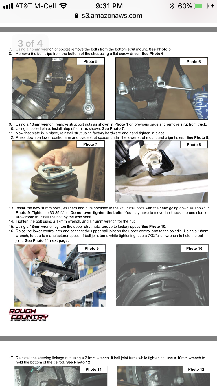

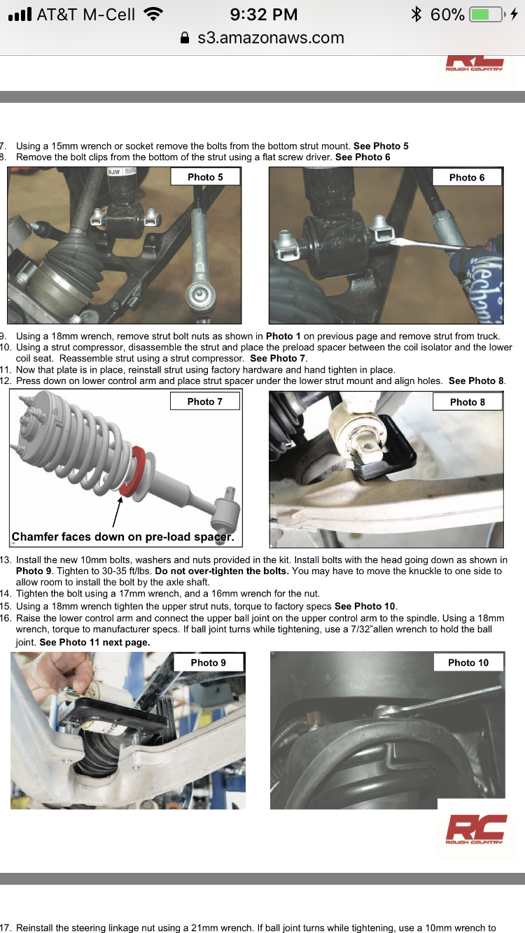

Alright folks, got some Readylift UCA’s on the way, and also purchased the RC 2.5” leveling kit for stamped steel UCA’s.
Im looking at the instructions and for thr stamped uca kit the top spacer goes under the coil.
looking at the instructions for cast steel the top spacer goes on top of the strut.

With the kit for for stamped steel arms the top spacer goes underneath the coil
since I am upgrading the uca’s im assuming I can just run the standard above the strut spacer kit but im not sure, this is my first truck and first time doing any leveling
the complete Readylift kit has a top of the strut spacer, if you get just the leveling kit with no UCA’s it recommends upgrading from stamped steel arms to factory cast aluminum or their tubular arms.
I chatted with Rough Country and told them I upgraded the UCA’s so could I run the standard kit, they asked if I changed out the knuckle, and if I did not then I should still run the under the coil top spacer, but that sounds kind of odd to me? If I am able to swap them from stamped to cast then the knuckle should be no different is what im thinking?

If I could afford the fox I would def go that route, but Its out of my price range, and I already have both the RC kit and Readylift UCA’s on hand. I think im going to order up the standard top spacers and see if it works out. Everything im reading says the ball joint on the stamped and aluminum uca’s are the same, the knuckle is smaller on the stamped but still fits the same ball joint, and every other leveling kit other than RC has a top of the strut spacer for the stamped arms. :dunno:
