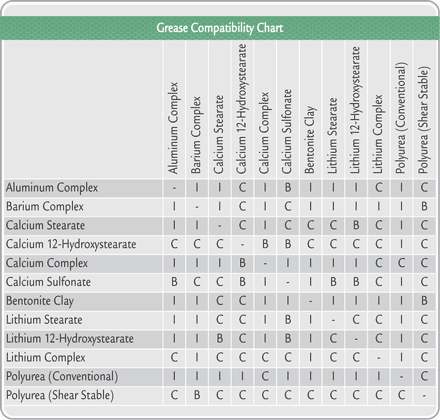

You probably already know this, but make sure you don't mix grease types. The grease in the bearing from the factory may differ from the type you are going to add. If they are not compatible, the grease will turn to a liquid similar to pen ink, or it can turn hard and chalky. Either way, it destroys your bearings. You must clean the old grease out completely, with paper towels, Q-tips, and brake cleaner. Then you can apply new grease.

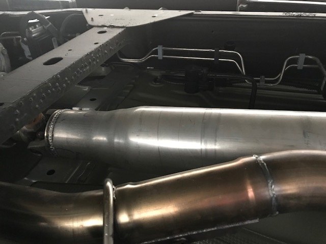

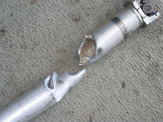

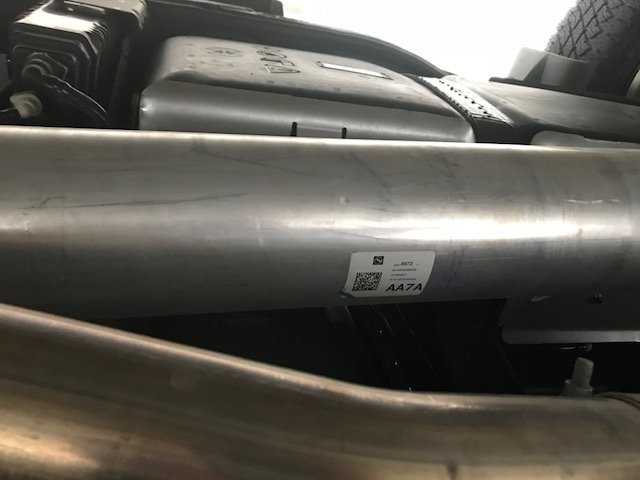

Are you sure there is not a piece of metal bouncing around inside your driveshaft? Like inside the center of the hollow driveshaft tube.
  As you can see, they are hollow:
