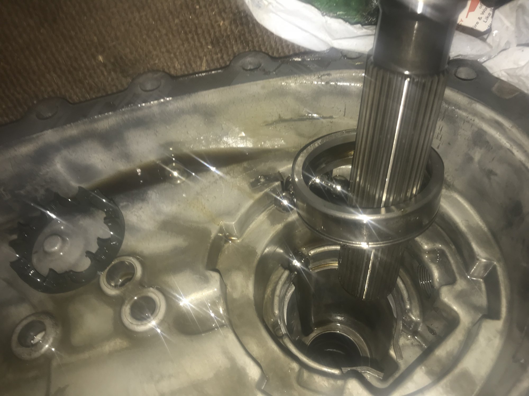

It was indeed the transfer case. Luckily I had the donor vehicle with similar np246 transfer case and was able to swap what I needed around. This is how the old transfer case came apart. Didn’t even touch the bearing! This bearing was the noise I was able to hear and what caused my issues. Everything seems to be smooth now.
