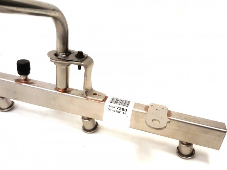

         Do the fuel rails look like this?
No :/ theyre a weird design that's held in by a torx bolt (like those ones) but also has other ways of holding itself in place. I'll upload a picture
Ok so you can see here that they're held in place by 4 tabs on each clip, and it doesnt just slide straight back away from the crossover. The part of the clip that sinks down with the crossover keeps it from going straight back.
  Look pretty simple to me. Just pull that torx bolt out and then bend the metal tabs back enough to slip the retaining bracket off.

I tried that already but like I said, it doesnt pull off backwards. You can see the clip bends down where the crossover goes into the rail and because of that, it doesnt slide backward.

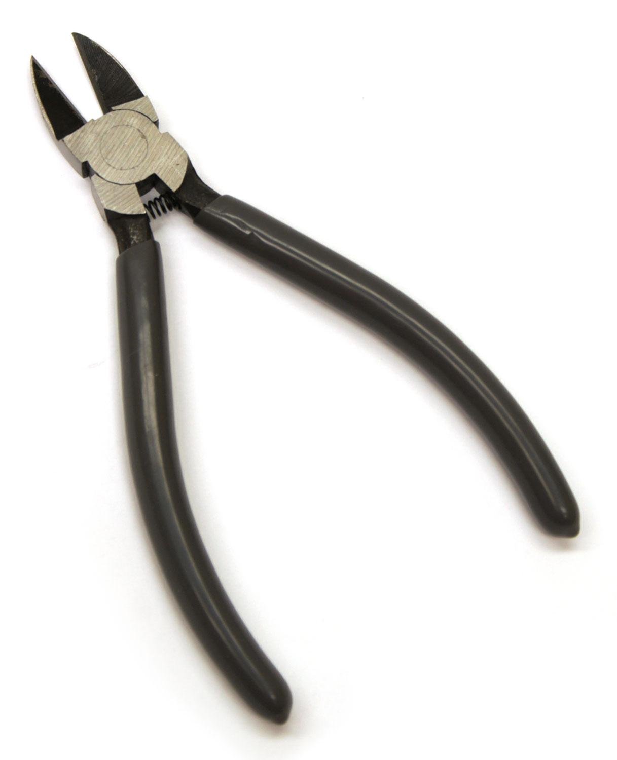

  There are (4) clips that are visible. You bent 2. Bend all 4, and pull the bracket strait up. If the front clips connect under that bracket, just cut it with a pair of dikes.
