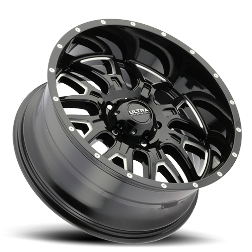

What size tire for these wheels
Just purchased these ultra hunter wheels and I'm curious if something. I'm going to throw a 32 inch tire on it but what would the widest tire I should put on it with stock suspension.
OEM wheel was 17x8 with +24 mm offset
OEM tire 255 70 17 (31.1" diameter with 10" width)
New Wheel 20x9 with +18mm offset
What's a size for a 32" wheel that with give a nice slightly round off road looking sidewall
Also what is new GM part number for TPMS sensor? Which tpms relearn do you guys have?
