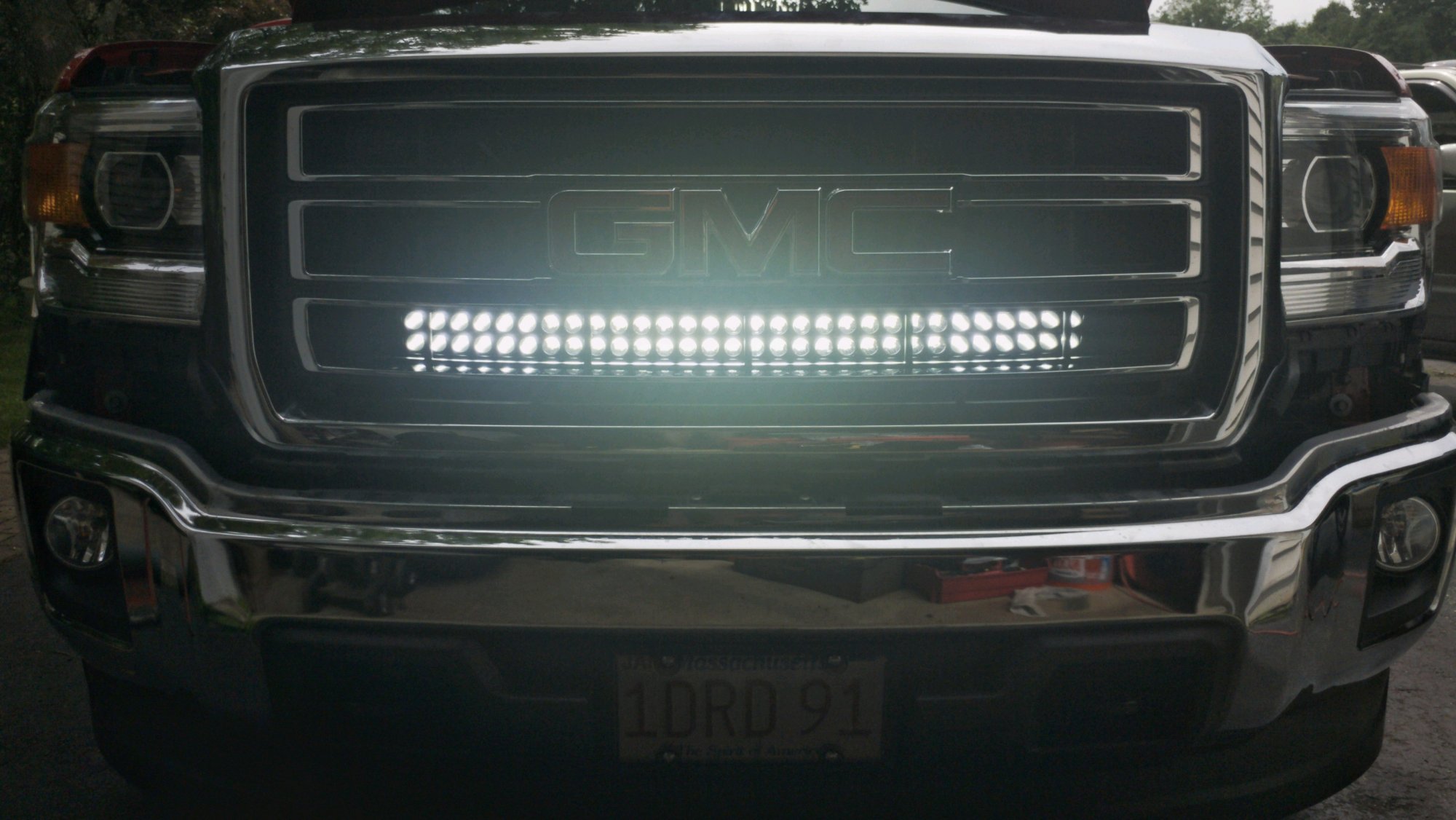

The first mod I did was a 32" lightbar, I had it sitting in my Amazon cart just waiting to find a truck so that went in almost immediately. It's hooked up to a remote that I was hoping would work with my homelink but unfortunately didn't. In the future I would like to either get grill inserts or change the grill completely so the light won't be as obvious but I'm very happy with the results. The only con is that I can't adjust the angle without taking the grill off so I may need to cut down an allen key in the future for that.

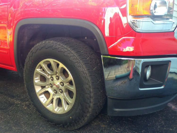

Threw the Falken Wildpeak ATW3 tires on in 265/70r18. Huge upgrade from the stock SR-As.

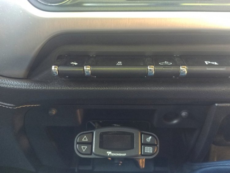

Also installed a Tekasha P3, after going through all the usual options I decided to remove the cubby door and install it there. Within easy reach and from the seated position it looks like it belongs.
Looks good. I've been contemplating putting something in there as I never use that cubby.
