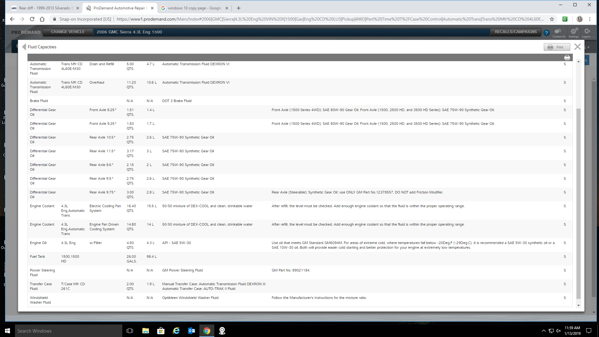

Im looking to change the rear diff fluid in my 2006 sierrra. its a standard cab, 4.3L, 4x4, WT edition. i know its got 3.73s in it, but im looking for rear axle size to buy correct fluid. Ive seen 75w-90, but different amounts, depending on diff size. Any answers?

Yeah, thats where I got conflicting info on what weight to use, not how much.
Use 75w-90 and you're good or use what you've got already, 80w-90. I just use 75w-90 in both ends.No need for different visc. between the two
From your owner's manual:
Rear Axle SAE 75W-90 Synthetic Axle
Lubricant (GM Part No. 12378261)
or equivalent meeting GM
Specification 9986115.
