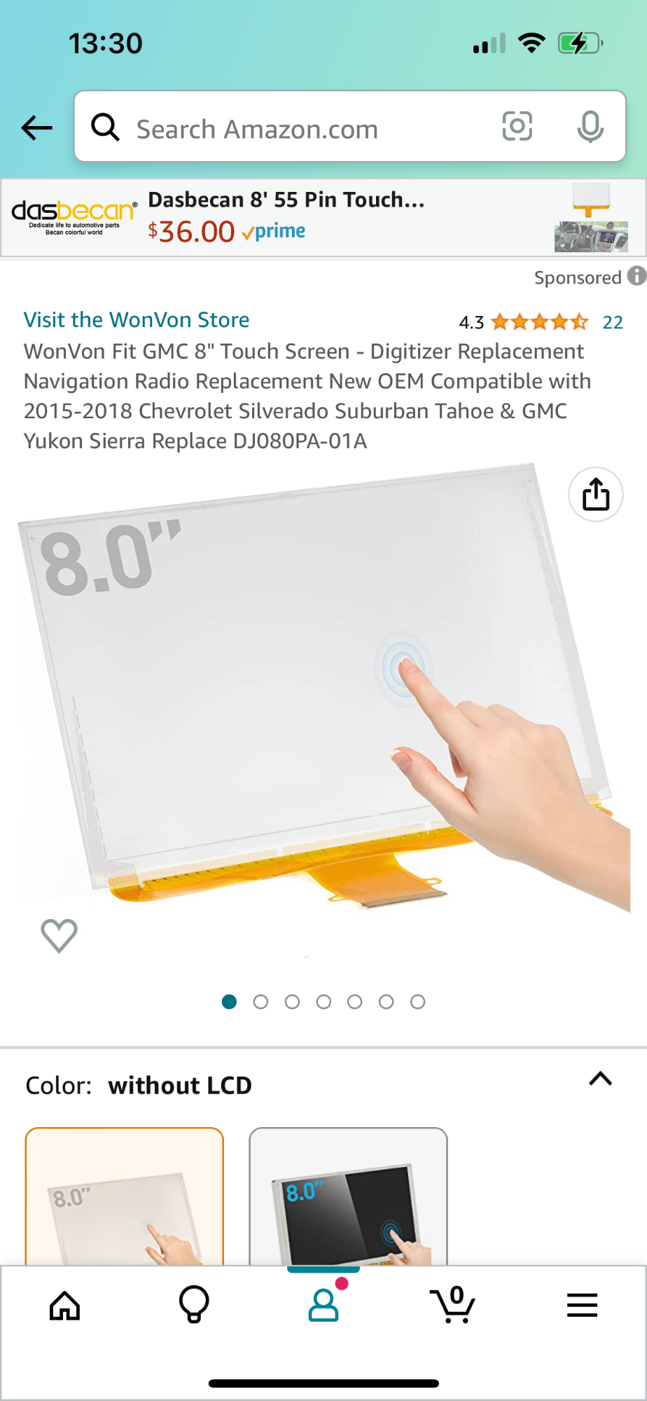

We have the same problem with our 2017 Colorado. I need a fix before my husband punches the screen! Specifically, what digitiser do l need to buy?
